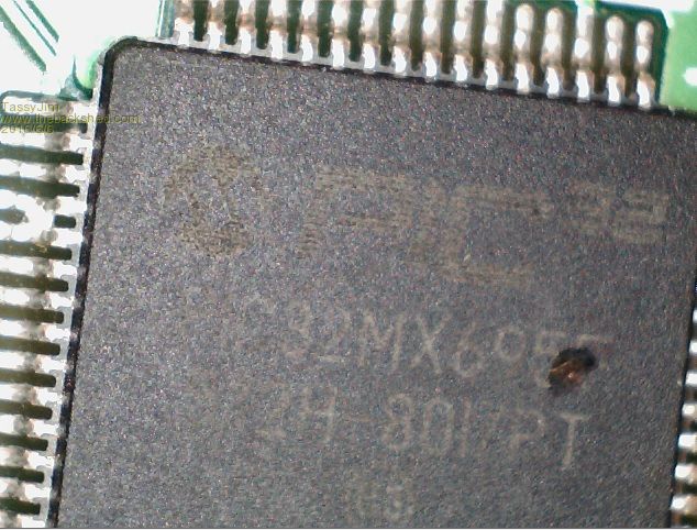

Lame. I expected more.
@Grogster
Just for you - Let the smoke out
Posts: 10065
Posted: 07:08pm 05 Jun 2016
....it's a pretty orange....
