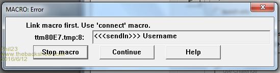

Hi all,
Can anyone hep out with this annoying Tera term issue.
Well more accurately Tera Term Menu.
I've search for answers 1000 times, & only see obscure information.
Seems like there is a temporary macro created.
I can just hit stop macro & it goes away, but surely there's an easy fix.
Hopefully the screen grabs explain it.
Phil.
Posts: 6624
Posted: 02:32pm 12 Jun 2016
You are trying to login automatically when you start.
TeraTerm is looking for the USERNAME prompt.
Try 'Launch only'

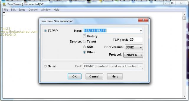

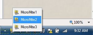

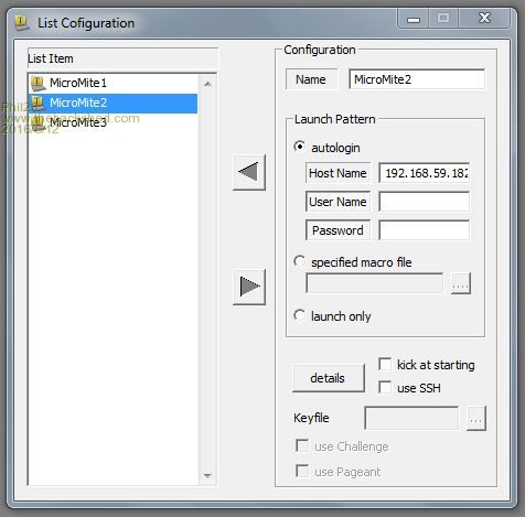

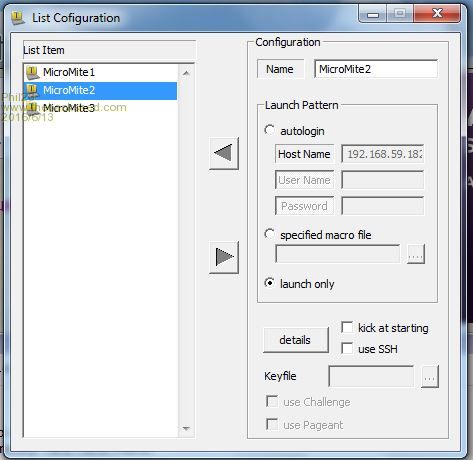

I had previously tried "Launch Only", but it does not seem to pass the IP address to Teraterm.
Tried it again just now & same result.
It just presents me with a new connection window with 192.168.59.181 as the only option in the drop down list.
On Autologin it connects to the correct IP, with the error in a background window.
The macro file seems to be a random name. Like ttm7EB2.tmp in this instance.
The error on exit says "Link Macro First". which makes no sense with a tmp file.
It's no biggie, I just click past it.
Just find it rather annoying when software has these little issues & solutions are poorly documented.
Cheers.
