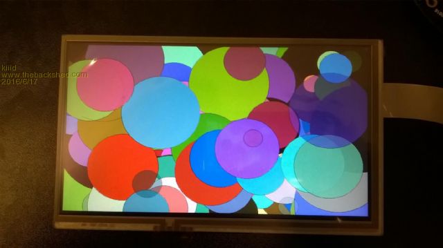

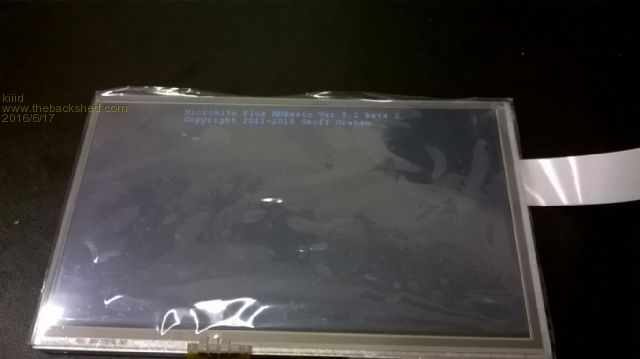

I am experimenting with a LCD panel with built-in SSD1963 from Winstar. It works fine, but the picture is shifted right. I tried with all possible SSD1963 options; with some of them the picture is more towards the left, with others more on the right side, but none of them had it in the centre. Is there anything that I can do to adjust the position?

Re the first question. What resolution is the screen? Do Winstar give any recommended initialisation parameters?

Posted: 12:02am 17 Jun 2016
The panel is 800x480 resolution.
Fortunately Winstar have provided initialisation reference in the datasheet, but it doesn't match any of the options currently available in MM+.
I created a new structure for an option SSD1963_7W and copied the one from _7A.
Changed the two horizontal porch parameters like this:
SSD1963HorizBackPorch = 46;
SSD1963HorizFrontPorch = 210;
but it is still shifted although a bit less...

I've got it working now! This is my structure:
case SSD1963_7W: DisplayHRes = 800; // this is a 7" glass Winstar version
DisplayVRes = 480;
SSD1963HorizPulseWidth = 0;
SSD1963VertPulseWidth = 2;
SSD1963VertBackPorch = 25;
SSD1963VertFrontPorch = 18;
SSD1963PClock1 = 0x03;
SSD1963PClock2 = 0xff;
SSD1963PClock3 = 0xff;
SSD1963Mode1 = 0x24; // 24-bit for 7" panel
SSD1963Mode2 = 0x80; // TTL mode
break;
The picture of this panel is very bright and clear.
