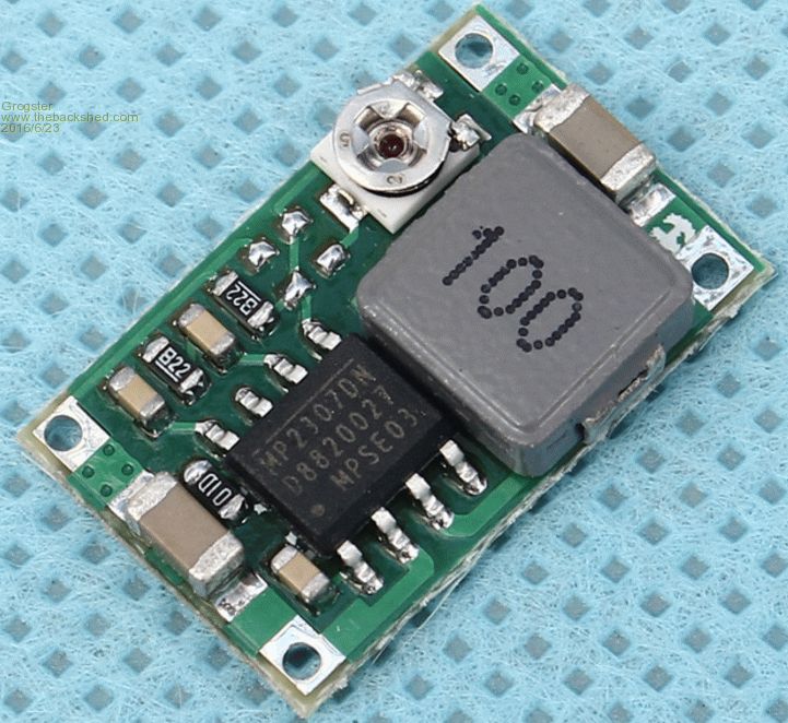

How about these 9mm x 17mm modules.
US$2.86 for FIVE modules. 4.75v-23v input, 1v - 17v output.
1.8A continuous, 3A surge.
I have not yet found the datasheet for the regulator IC, but am looking for it now.
I will post a link once I find it.
EDIT: Datasheet Link for the MP2307DN IC.... Edited by Grogster 2016-06-24

Posts: 12026
Posted: 01:01am 23 Jun 2016
  Quote  If so, are there any 'negatives' with them?
They look great, the only thing that jumps out is 220uF max capacitive load and I wouldn't use one if using the Micromite's ADC
Posts: 2994
Posted: 01:17am 23 Jun 2016
  matherp said  . . .the only thing that jumps out is 220uF max capacitive load and I wouldn't use one if using the Micromite's ADC
Useful to know - for now my MM circuits this is for are not using ADC.
With a minimal knowledge of analogue electronics, why would this max capacitive load affect ADC (in simple speak!)?

Posts: 12026
Posted: 01:20am 23 Jun 2016
  Quote  why would this max capacitive load affect ADC (in simple speak!)?
Unrelated points.
ADC issue is that it is a switch mode regulator and has max ripple of 150mV. If ADC is required I would use a 5V version and then LDO to get a good 3V3
