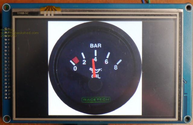

This thread tries to present fairly general purpose code that can be used to display photo-realistic gauges on a SSD1963 display. This is really the same code as presented here but I will try and explain a bit better how it works.

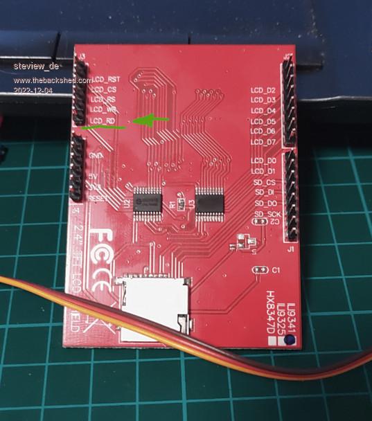

First things first - this only works on a SSD1963 display in which the RD pin is connected to the Micromite (like the Explore 100 )
See this live video
The program works by overlaying a Micromite generated pointer on top of an image of the display loaded from SD card.
The first 4 lines in the program define where on the display the image is to be drawn and where the pivot of the pointer is relative to the top left corner of the image

In my example code the program just sweeps the pointer from 45 degrees left of centre to 45 degrees right. Normally of course this will be using some sort of data reading to drive the display.

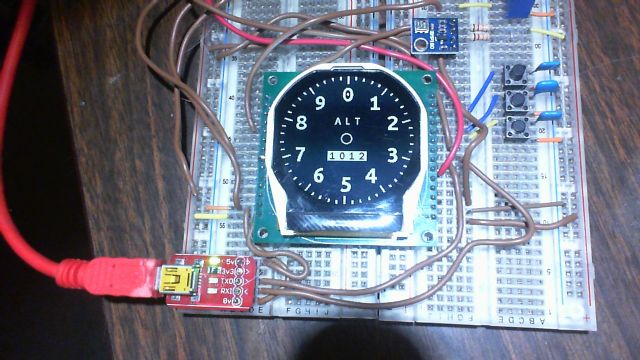

I like your ALT gauge graphic you have there - looks very realistic from the photo
Would be good to see that working smoothly with a moving pointer and changing number.
Do keep us updated . . . .

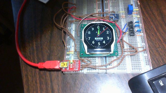

Hey Gang...
Just an update for the ALT gauge.. The code is still very much in prototype stage, as I need to add a user interface to change the the current displayed altitude.. Currently I am using just 3 buttons to change things, but still waiting for the push button encoders to come in... the code currently changes the QNH number to effect the display...
A big tip of the hat goes to Peter M. for creating the code that makes this thing work..! He also updated the R61505V display driver code that uses the RD pin on the display that allows the needles to not disturb the gauge face.. I will be re doing the PCB's after more parts arrive... Hopefully I can group the code together and will end up with a unit that will cover 2 channels of temps (EGT,CHT,OIL,OAT) ect.. as well as a voltmeter and Altimeter... Still working on getting an RPM and Airspeed into the mix as well... Fun stuff..!! Attached the proto code if interested....

That looks so neat - great work there by both Peter and your goodself!
Next week I am planning on ordering various TFTs for selling on the mm.org website. I would very much like to use a photo/video of your meter if that is ok. Two Q's, do you know who manufactures these round TFTs? And what is the viewing angle like on this particular TFT you are using (guesstimate of horizontal & vertical angle before 'drastic' colour change is good enough).
Nice USB module by the way
