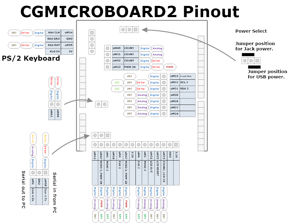

Just wondering if this is a feasible addition to the product line.
Thinking of @Grogster, @Bigmik & @Geoffg.
Geoff's original is a great form factor & very versatile.
Only limitation is I/O pins.
Use I²C for an RTC & decide to implement Com's & you are down to just 7 pins left.
So does a 44 Pin version of this form factor make sense?
Basically similar to the existing one, just with the additional 14 pins on the bottom edge of the board.
Alternatively, I²C & Com1 pins could be grouped with their own Gnd & Power, much like the existing console connection, making direct connection to those devices very simple.
Obviously the bigger backpacks, like the upcoming Explore 100 would blow it out of the water, but they won't have that very compacts form.
Think there will always be a demand for that.

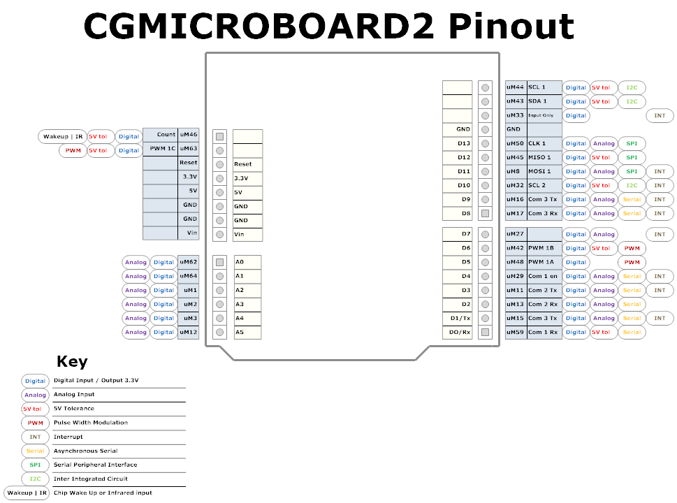

How about the CGMICROBOARD2?

Look like just the right thing.
Might need to add one to my collection.
Thanks.
Phil.
Edit:-

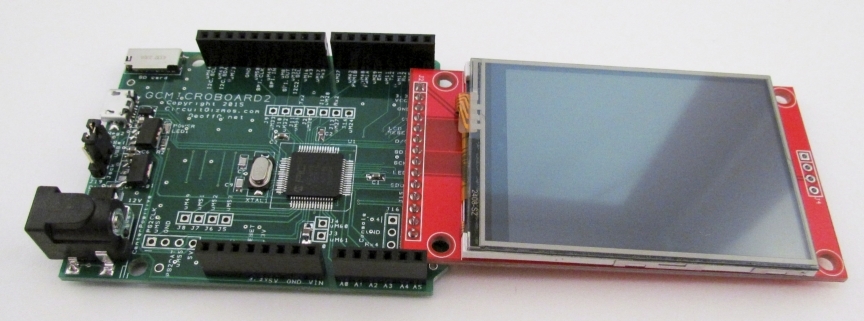

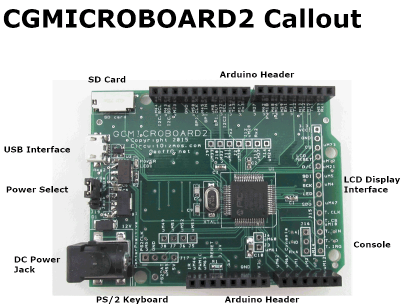

Can't quite tell from the photos, but how is the LCD usually attached.
In the first photo is it directly soldered, or on a socket strip.
Can see the screw holes are not used.Edited by Phil23 2016-07-09
CircuitGizmos
Joined: 08/09/2011
Posts: 1427
Posted: 06:57am 10 Jul 2016
The CGMICROBOARD2 follows the pin placement and hole positions of the arduino shield. These don't match up with the holes on the LCD.
Solder directly or use pin headers - that is up to you. You can use 2.2, 2.4, or 2.8" LCD. Some smaller ones also work.

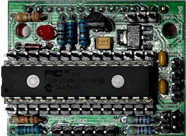

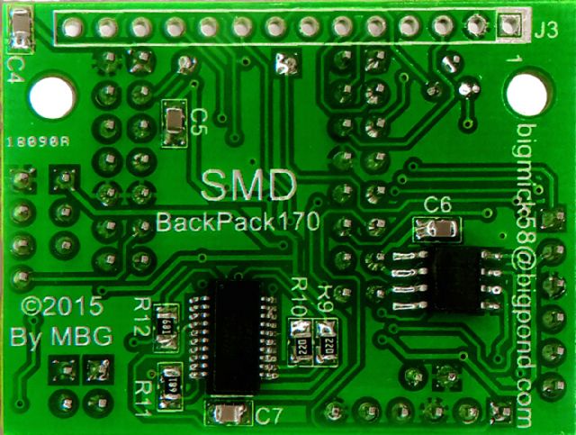

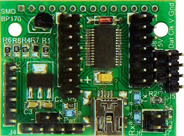

Posts: 2982
Posted: 08:23pm 23 Jul 2016
GDay Phil,
It is probably too late but my 28pin based BackPacks have every IO pin accessible for use: Both boards are only 43.5mm x 32.5mm (1.71” x 1.28”) Full details as follows:
BackPack170
and
SMD BackPack170
TOP VIEW
BOTTOM VIEW
