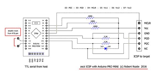

Rob - my version of the mini isn't getting VCC on pins 7,6 and 5. Probably 'cause it's a chinese clone I guess and a little bit different to normal. I'm getting VCC on pins 8 and 9 though. I might jumper those two across along with a third VCC pin I have.
Posts: 2552
Posted: 04:13am 15 Jul 2016
that is odd, D2 to D7 are connected to the 328p processor pins PD2 to PD7 on both the nano and pro-mini schematics i have here, so should in theory all behave exactly the same. even chinese clones should follow the same pin wiring between the 328p and the pins around the PCB.
you should have something that looks like this:
i think i have the above pinouts all correct - this is based upon info from the web, not an actual construction.
(oops: i have RTS instead of DTR marked on the schematic)
apart from Vcc (3v3) everything else worked ok, and your micromite is up and running the 5.2 version of mmbasic?
rob :-)Edited by robert.rozee 2016-07-16

Last part of your question - yes, all working nicely thanks to your schematic. I just add power elsewhere to the backpack currently. I'll be having a look at the power side of things tonight. Will advise.
thirsty
Joined: 22/06/2016
Posts: 34
Posted: 09:54pm 15 Jul 2016
So I stole some power from 3 other pins that had 5v and linked them to the three 100r resistors and am programming firmware in right now.
