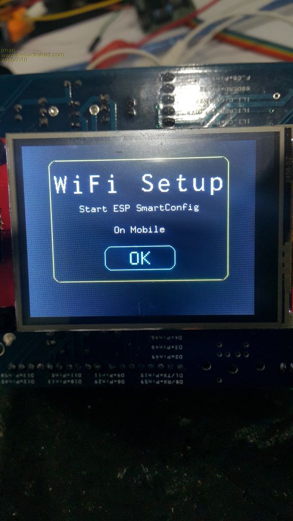

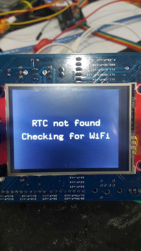

After seeing Geoff's new Super Clock I decided to add a third time source
and sound (Talkning clock)
First the WiFi. This is based on an ESP8266 (Of Course) with the linked AT firmware. This firmware requires 8MB of flash. In the attachement is a screen shot of the settings required to flash the ESP8266.

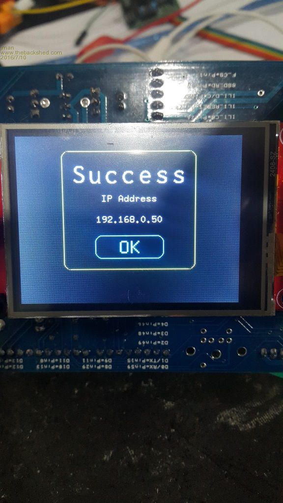

Instead of hard coding the SSID and WiFi password i decided to use SmartConfig
this requires an application that runs on your Android device and configures the ESP8266 using your Android devices current WiFi settings.
The App is from the Play Store and can be found here ESP8266 SmartConfig
You will need to set your NTP server in NTP$="you server goes here"
this can be an IP address or FQDN

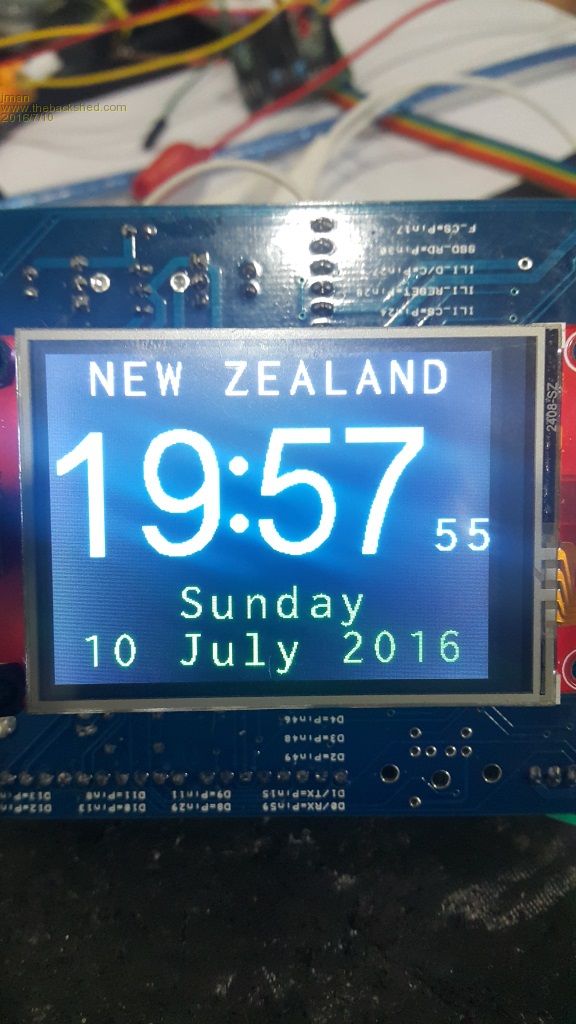

The touch has been changed so that the left 1/3 of the screen when touched
the clock will speak the time. If you set MP3=0 then this be go back to been the left scroll area and the MP3 module will not be used.
