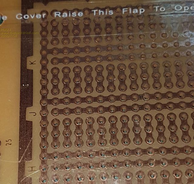

Building this on prototyping board.
The type that has 3 pin strips running vertically & ground & power strips running horizontally. Power from one side ground from the other.
This stuff.
At the moment all my thermistor's grounds are to a common track, which goes all over the board.
Do I take a close connection to this track directly back to the analogue ground?
Sorry if I seem a bit vague on understanding this end of the connections.
Right now AVss is going to a track about 6 strips away.
Phil.Edited by Phil23 2016-07-15
