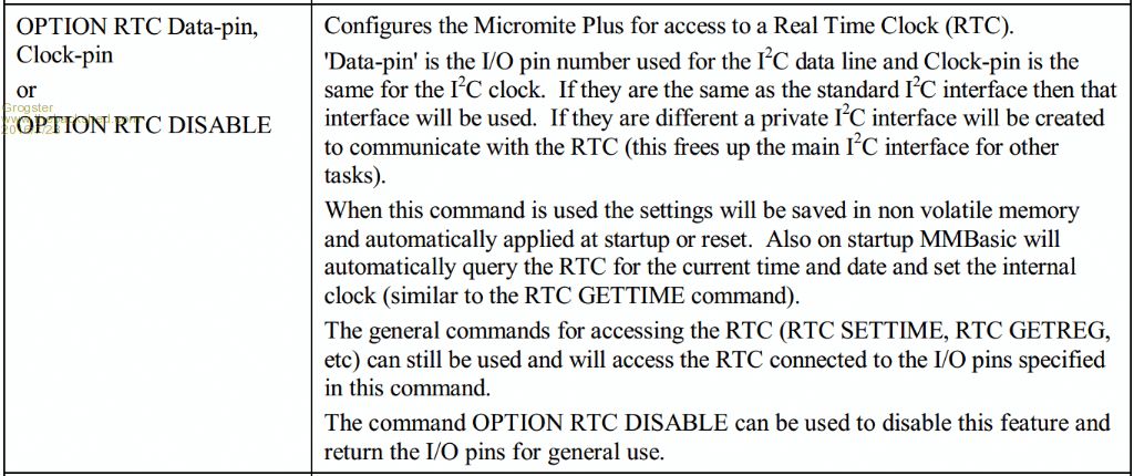

Hi All
The above command is mentioned in the manual but it's not listed under the Commands section of the manual.
I assume usage is OPTION RTC 23,32 or whatever pins are to be used for the clock.
Is that correct?

No Options are required for the RTC, it's all internal.
It just connects to the I²C pins on the Micromite.
17 & 18 on the 28 Pin chip.
See Pages 7 & 26.

Yes, just as Phil says, the MM takes care of all that for you. Just connect it up to the I2C port, and use the two RTC commands: RTC GETTIME and RTC SETTIME, and the MM will do all the work for you - can't get any easier then that!
The MM will automatically use any compatible RTC chip including the DS1307, DS3231, DS3232, PCF8563 and M41T11 - plenty of choices. I recommend you use the DS3231 or DS3232, as they are very accurate. The 1307 is a bad choice these days with the 3231 or 3232 modules on eBay being so cheap - and you get an EEPROM on those modules too......

OPTION RTC is only available on the Micromite Plus and is documented in the Micromite Plus Addendum page 47.

Yes, that is a point - I was only thinking standard MM2, but if thirsty is using a MM+......
From the Advanced manual, page 47 as above:

Thanks guys, not sure how I missed that entry in the manual as I did a search but still missed it! I'm using a ds3231 module and the standard i2c interface currently and it just works! Very nice.
