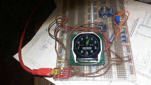

It's been awhile since I posted an update.. I took a side track and did Lou's PEMF Coil Driver PCB which should be on it's way from Iteed soon... So, back to Gauge code...
I changed the user interface from push buttons to an encoder type control with push "select" button, which works like the old school gauge. Also included 2 setup screens to change either the QNH scaled in in/mg or ALT in ten's of feet. I will be building a battery powered "test" unit and have my Bro Dave take it up for a test flight to see if it seems to work ok...
I big tip of the hat to Peter for writing the BMP180 and updated R61505V driver which supports the RD pin, that makes all this work..!
Since the gauge interface board also contains an Rs-485 transceiver, I am now thinking of transmitting the ALT information to another gauge display and create a "rate of climb" type unit... Should be doable... Project code attached if interested...

Looking really good. QNH entry in millibars ( a.k.a hectapacals ) would make it universal.
Shame that your Aliexpress supplier no longer stocks the LCD, only a slightly smaller 2.0" version of lesser resolution.
Bill
Bill
lew247
Joined: 23/12/2015
Posts: 1709
Posted: 11:06pm 22 Jul 2016
Beautiful work, I love the thin red needle
Is the background - the Black with the numbers a background picture or drawn by the Micromite?

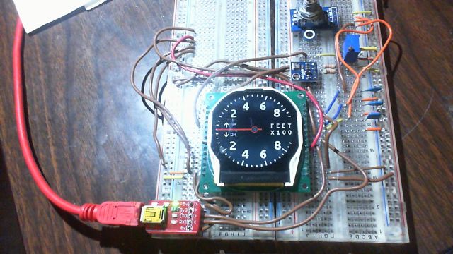

Posted: 04:23pm 10 Aug 2016
Vertical Speed Indicator add on...
I am still trying to get this worked out, but got the background screen worked up...
Instead of using 2 gauge displays, I think I can just hit the button and switch between them... I think I will need some help from Peter Mather on how to properly control the needle objects buffer to switch from showing 3 needles to just 1 on the vario display... I tried just clearing the "buff()" array but can't seem to clear the other 2 needles once they exist..
@lew247 - The needle designs are the same ones Peter used in the clock demo that he wrote and posted.. I haven't created new ones yet, and maybe don't need to as these seem to look OK as is... The gauge backgrounds are just drawn using the tick mark SUB, (again a modification of Peters code) and the fonts loaded into the library flash area... (see code example above)
@Bill7300 - The original code from Peter was displayed in millibars (hectapacals) and I just changed it to in/mg... I think I could include a setup screen to allow the end user to change it to either type if wanted...
Also, the hand held prototype test unit went "flying" yesterday thanks to Bro Dave and a CFI he is training with.. One confusing thing is that entering the ATIS info from the airports seems to be just the airports "local" air pressure and is not "adjusted" the sea level pressure (as in QNH) I am still trying to get the correct answers to this question... (don't know yet)...
Anyway, still workin on it... I did order the 10 new displays from the WayEngineer site and they seem to be on the way... Still lot's of work to do... But with some help from Peter, I think this Gauge should be possible... Next, I want to take a crack at doing an airspeed gauge... still looking at proper sensors... the Servflow website has a few that use the SPI interface that look good, But I am in enough trouble just getting this one worked out for now... I don't get enough time to spend "in big chunks", so progress is slow... (yikes.. 10 hour days at work)... I still have some vacation days left so when the Rev-B PCB's get here I will get some built up and start on getting the encoder knob designed onto the interface board...
A big tip of the hat goes to Peter Mather for all the code he has created to make this thing work..!!!

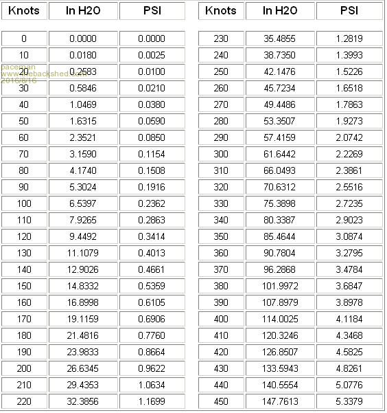

I am kinda new at trying to select sensors and could not seem to find a "cheat sheet" that does all the conversion between in of H2O, PSI and k/pa...
  Quote  The table I have says ramspeed at 100 Knots is 0.236 psi, i.e. 6.54" H2O,
Can I see a copy of your conversion table you use Greg..?
So Peter, I would then take the analog output into the MM A/D pin without any voltage scaling. Glancing at the data sheet seems to say 1 volt per kPa and spans to 3.92 volts at it's "top of scale"... So, since it is higher than 3.3 volts, what would be a good way of protecting the MM pin..? Also, I read in the data sheet their output at 3 volts is 3 kPa or 306 mm H2O... (here we go again)...
Anyway, I am having trouble wrapping my little (8-bit) brain around all this, and need a little (a lot) of help getting this voltage converted into speed to show on the gauge face...
Thanks MUCH Gent's for your help on this (for me hard) stuff..!!

  Zonker said  Can I see a copy of your conversion table you use Greg..?
It's in a .jpg file unfortunately but here 'tis.
Bill's link to the BarkerAircraft kit using the vane and Hall sensor looks a very good option though too. Pretty good at US$60 over your way. Mounting it his way on the ASI pitot would make things easier too. I'm not sure quite where you'd need to mount the pitot for the differential pressure type but it would certainly be a more complicated and expensive option. His circuit and method of mounting the LED's in a 2.25" gauge would match nicely too if your current instruments are 2.25 inchers - which my brother-in-law's are, but the analogue outputs are still there for the MMBasic and round LCD display approach.
BTW, you can get pretty much any conversion quickly by just Googling "CONVERT blah to blah" in you browser - the factors are usually given too.
