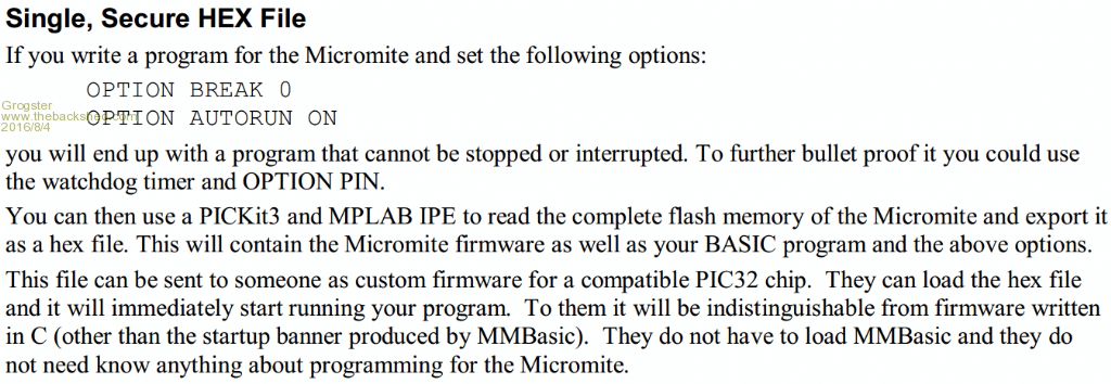

Hi all,
Have just had another complete crash on an MX170 Backpack.
I'm guessing as usual its due to my prototype construction, probably Wifi or coms gone crazy. That or a dodgy connection relating to power supply.
But, have a question about recovering it.
This is what I generally do.
[Code]Connect the Pickit & reflash.
Then connect a CP2102 to reconfigure Baud rate, Display & Touch.
Recalibrate Touch screen.
Plug it & reload my code.[/code]
What I want to know is can I create a Hex file for recovering from these situation;
rare but a pain.
Presue the Hex file would contain everything to return it to it's previous state.
Probably even Touch Calibration for an individual device.
I can read from IPE, but not sure about creating the Hex file from there.
Only option I see that's relevant is File | Export.
Does that create a valid Hex file that would be a complete backup of what's currently in a chip?
Phil
Posts: 10065
Posted: 09:37pm 03 Aug 2016
Yes.
Configure the chip how you want it.
Using PK3 and IPE, READ the chip instead of writing to it.
This will read the entire memory into a new HEX file, which you name and save somewhere.
If you reflash THAT file back into your MM chip, it will be pre-configured to talk to the RTC, LCD etc, etc, etc......
Naturally, that only works if you KNOW the situation it is going to be used in, otherwise it may cause something buggy to happen - like if it tries to talk to an LCD, and there is not one there - that kind of thing.
See the manual, page 16:
  Phil23 said  I can read from IPE, but not sure about creating the Hex file from there. Only option I see that's relevant is File | Export.
YES.
So, your steps would be:
1) Configure the MM however you want, and are happy everything is working.
2) Use the PK3 and IPE to READ the device.
3) FILE | EXPORT > HEX
4) Give the file a name, and click SAVE.
Done.
