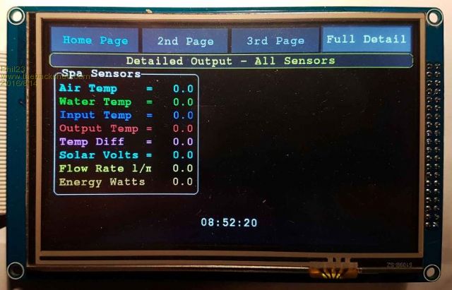

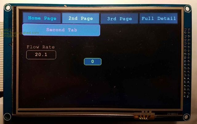

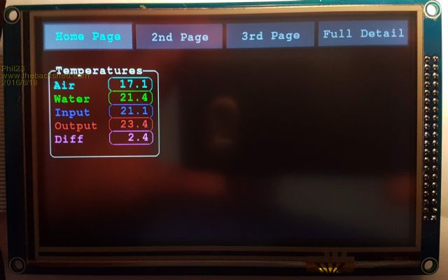

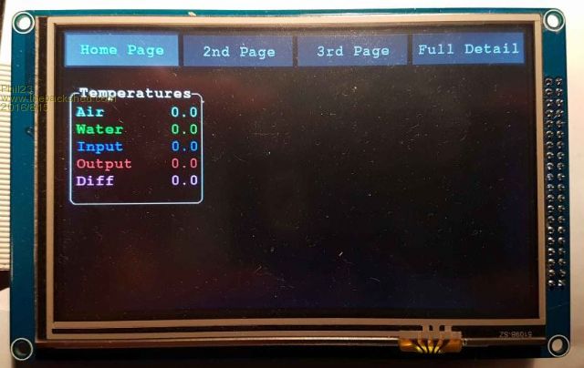

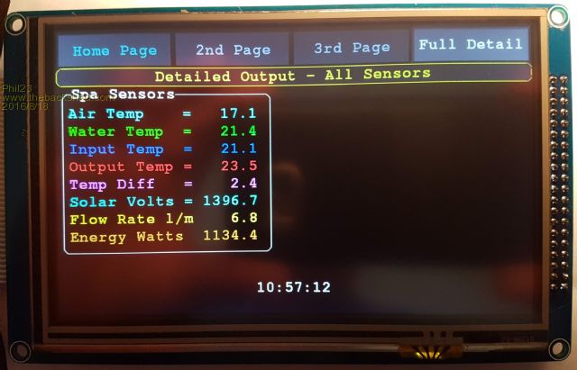

Hi All,
I've only played a little with the MM+ GUI, scaling down Geoff's Pump demo.
It's pretty small on a 2.8" screen, but I can see a good application, where the other screens would be too big.
What I'm thinking of is a Tabbed approach to the multiple pages, a bit like Browser tabs.
Wondering what people think about the best approach to achieving this is.
General starting points & suggestions I suppose.
Thinking out loud....
Phil.

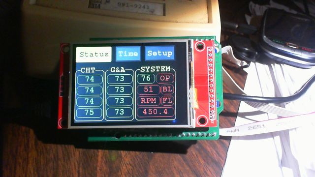

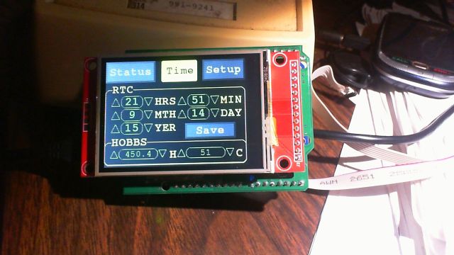

Zonker
Joined: 18/08/2012
Posts: 772
Posted: 05:16pm 06 Aug 2016

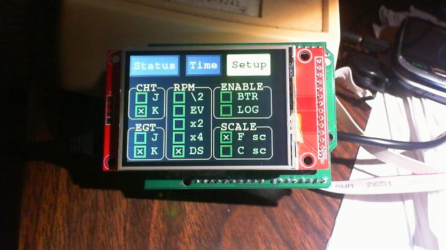

Yep..! It works like a champ...
I did this on a small "tabbed" screen setup
I does seem to get crowded kinda fast, but doable...
When things get to small, the "fat finger" starts getting into trouble...
Must be time for a bigger panel..!!
Phil23
Joined: 27/03/2016
Posts: 1667
Posted: 05:33pm 06 Aug 2016
  Zonker said   Yep..! It works like a champ...
[/quote]
So are the Tab Buttons defined on each page?
Or are they separate controls with no page defined.
I could think of maybe 3 different ways to approach this, but don't quite know which is best, (or what won't work for that matter.
The other though that comes to mind is 4 pages;
1 that just contains the Tabs at the top, while the 3 other contain the lower elements.

Zonker
Joined: 18/08/2012
Posts: 772
Posted: 06:15pm 06 Aug 2016
Humm... I did look up the code... From 8/22/15... It's not "up to date" with latest GUI firmware, but could work as a starting point fot the "tab" objects...
' LTC2983 Test Program for MM+470 on the GC microboard 2
Option explicit
' Assign Object Values

GUI hide egt1_data_box,egt2_data_box,egt3_data_box,egt4_data_box
GUI hide egt_data_frame
EndIf
If old_screen_state=status_button Then ' hide status screen objects
GUI restore status_button
GUI hide cht1_led,cht2_led,cht3_led,cht4_led
GUI hide cht_stat_box
GUI hide egt1_led,egt2_led,egt3_led,egt4_led
GUI hide egt_stat_box
GUI hide temps_stat_frame
EndIf
GUI restore cht_thermo_type_frame
GUI restore cht_jtype_button,cht_ktype_button
GUI restore egt_thermo_type_frame
GUI restore egt_jtype_button,egt_ktype_button
GUI restore rpm_count_frame,rpm_dev2_button,rpm_even_button
GUI restore rpm_mul2_button ',rpm_mul4_button ',rpm_dis_button
End Select
old_screen_state=screen_state ' update old
End Sub
End
Use the basic tabbed framework and "touch action" sections, Insert your objects for the main sections of the screen and see how your screens work...
Post them back here so we can take a look..!
Phil23
Joined: 27/03/2016
Posts: 1667
Posted: 12:06am 07 Aug 2016
Just gave it a try on my CG board the same as yours.
Crashed at line 77;
[Code][77] GUI displaybox cht_stat_box,7,100,MM.FontWidth*19,MM.FontHeight+5,RGB(red),RGB(black)
Error: 456 is invalid (valid is 16 to 320)
[/code]
Presume that means I need to add the font you used in line 60.
Mid Sized Bold.
Phil.
Edit:-
What Firmware Version is the above running on Zonker?
Looks like the latest version differs a fair bit in terms of syntax.
Notice this with the GUI LED commands.Edited by Phil23 2016-08-08

Seems to be working well;
Have trapped the screen update issues caused if the interrupt occurs during the Basic Graphics updates.
Page 4 has a mix of Basic & Advanced Graphics & it will be intended to display all Sensor data & key variables used in the control process.
Mostly for Debugging & seeing what things are doing.
That will amount to about 40 variables to display, which I might split over 2 pages;
Way to many for them all to be advanced objects.
Data is being collected from 3 other MM's via HC-12's.
This one will poll for that data & acknowledge it's receipt.
Have that Com stuff running on a 28P Backpack ATM;
Multiple Basic Graphics Pages with switching.
Tried building a data string and using it with GUI CAPTION on Page1,
but the Caption string doesn't update.
Edit;-
Posted the image of the 4 tab twice, Fixed now.
1st Tab;
Data not working & needs changing
2nd Tab;
Just mucking about on it.
4th Tab;
It's the mix of Basic & Advanced & all working fine now.

Phil23
Joined: 27/03/2016
Posts: 1667
Posted: 03:28pm 17 Aug 2016
  Zonker said  I would love to see the sensor data on those value readouts...
Got some there now.
This data is being received on Com1 by a HC-12, which Polls the two other MM's,
one on the Spa, the other in the Heat Pump.
Home page is only Advanced Graphics.
Still requires 10 Objects to display 5 items of data.
Wouldn't mind seeing the option to suppress the border in the DISPLAYBOX though.
The other thing that would be good is display precision in the NUMBERBOX,
so you don't get situations where the decimal is dropped.
IE
29.8
29.9
30
30.1
30.2
This page uses the Mix of Basic & Advanced Graphics.

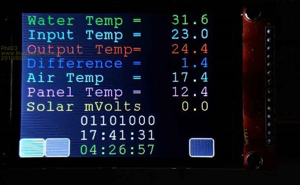

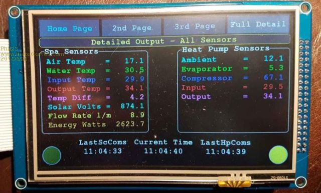

Posted: 03:18pm 19 Aug 2016
Just updated Tab 4 a bit.
Now displaying thermistor data from the heat pump.
Thermistors might need a bit better calibration yet.
Energy output is calculated from flow rate on the basis of 4.2kJ to raise 1 litre if water 1°C (Yes, I know, it's a kilo really...).
1kJ=0.000278kWh; then kWh's back to Watts.
Not bad, the 2600 Watts out for the 730 Watts of electricity in.
Incidentally, that tab would require 37 advanced GUI objects if it was all advanced graphics.
Currently it's using 5 & I can't break it yet.
Cheers.

[Quote=Zonker]Where do you get the sensor data from..?
[/quote]
The Spa has 4 DS18B20's installed in it & a flow sensor.
There's a small garden solar panel on the roof with the panels & a DS18B20 attached.
The Spa has it's own LCD Backpack to monitor all those & control the pumps & valves.
It has an ESP8266 on the console & a HC-12 on Com1.
The heat pump just has a bare 28 pin on protoboard that monitors the existing 5 thermistors in the unit.
It has the same wireless modules as the other one.
The 5" screen is connected to an E64 & it polls both the other.
Did you get my PM?
If you drop me an email address it can reply to that.
Phil.

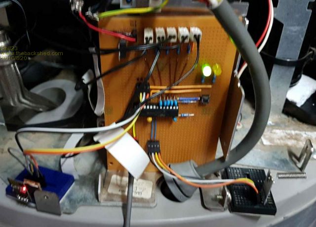

Just Adding to the above.
This is the 28 pin backpack that currently runs the Spa.
Uses a 3 level version of the Parking Sensors Menus to set the variables.
It will be replaced by a CGMicroboard2, with 2.8" LCD to obtain enable a better interface with Advanced graphics, but also because it's clean out of pins.
The one in the heat pump is still evolving.
It has the thermistors connected at the top, two LED's;
One indicated the code is still running, the second shows that Coms are happening.
It's the one that reads the flow meter at the moment, as I currently don't have a spare pin left on the Spa one to connect it to.
A 64 pin CG board will fix that, & the flow meter will be monitored by the Spa controller.
Phil
