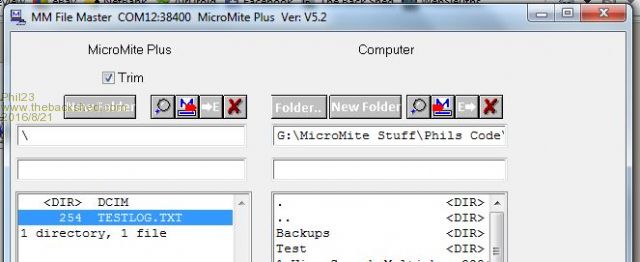

Hi All,
Want to start playing about with writing some data to the card.
Here's the difficult part:-
I'm playing around with an E64 on a breadboard birds nest at the moment,
So removing & replacing the card is a total PITA.
Am I right to assume I can just leave the card in & copy the file off to have a look with MMedit?
Haven't looked at how yet. Simple to do?
Thanks.
Posts: 6624
Posted: 02:23pm 20 Aug 2016
Short answer - No.
Long answer:
The maximite XMODEM command allowed copying to and from the SDcard.
The micromite only allows copying to the program memory. The option to do file copying is in the todo list but not yet.
If it happens, the File Manager in MMEdit would make life easy.
If you are only interested in text based files, you can easily incorporate the reading/writing into your own programs.
Alternatively, you could write a Basic XMODEM program to handle the stored files.
This is something I have considered but I am getting too far behind with other programming to make the offer.
Phil23
Joined: 27/03/2016
Posts: 1667
What am I missing here?
I can download my code; done that many times before.
But how to I copy my text file off the card?
Phil.
