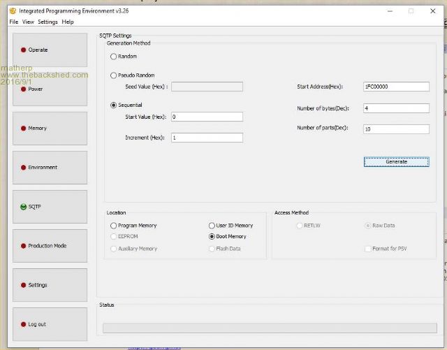

Hi to everybody
I need to know if it's possible to retrieve with a PIC32 instruction a CPUID or Serial Number. Or I ask to Geoff if it's possibile reserve about 10byte which is not affected by commands "new" "clear" etc. Then for example after the firwmare programm I can use "setSN" to save 10byte as string and "getSN" to retrieve the byte saved. These features on micromite.

I need to have the certainty to unique identify of the device. Without using variable, var save, uSD or external I2C flash.
But ...when you prepare the firmware ...can you create a constant and set for example a string as "<<hereSN>>"? Then I can prepare a free tools in windows to rewrite correct info in the firmware. And after to proceed to flash the PIC.

As Chronic says DEVCFG3 has a 16-bit user ID
Go into Advanced mode in the MPLABX IPE and look at SQTP. This can create an automatically incrementing or ID that can be set in DEVCFG3. This can be read/written with the pickit3
The only gotcha is that I haven't quickly been able to find out how/if you can read the location in a program. PEEK doesn't work, nor does a simple CFunction

In the bootflash area (starting at 0x9FC00000) there is plenty of space where you could store a serial number encoded in the hex file then read it using PEEK().
Bootflash is used for a variety of storage including the interrupt jump table, some MMBasic tables and PIC32 config words. The best way to find a suitable location is to write a simple program using PEEK() to dump the memory and pick a place where the flash is 0xFF as that is unused and unprogrammed. Don't use any address above 0x9FC00500 because that might be used by MMBasic in the future.

Posts: 12026
Posted: 05:10am 01 Sep 2016
Geoff's solution should work well
The SQTP settings in the IPE will write to that area so you won't even need to calculate checksums
