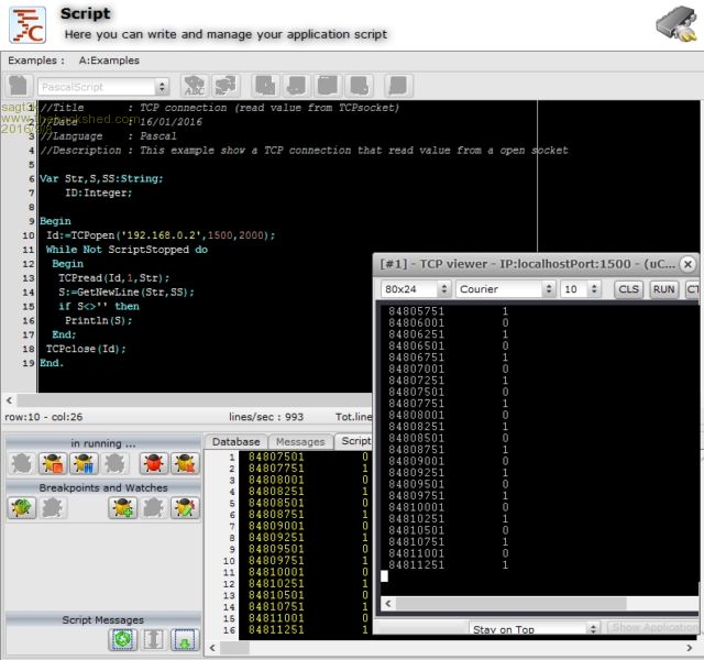

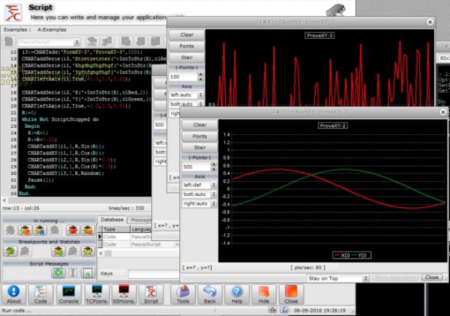

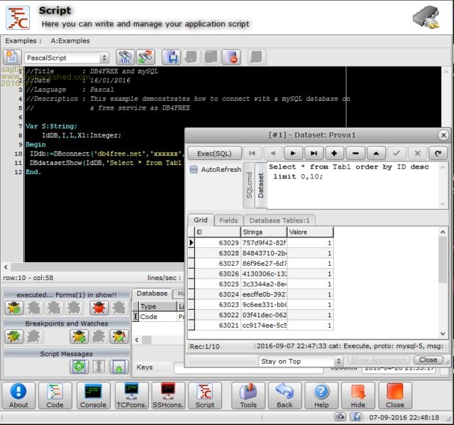

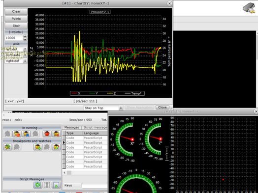

Hello to everybody
In this post I want to show some pictures of the new software that I'm going to present soon.
Here a list of some features and images:
- software is portable and run with all windows win32/64, WinXP/Vista//7/8.x/10
- integrated editor compatible with MMBasic
- not require installation and all the code is compress and encrypted in a single data file
- integrated console UART/USB and TCP/IP, all compatible with VT100 standard and MMBasic/Editor MKII
- it is possible to put any console COMx port to TCPserver:port
- it is possible to put any console TCP/port to another TCPserver:port
- infinite possibilities of connection and management also with multiple ports
- scripting engine in 4 languages (Basic,C,Pascal and JavaScript) with RUN and DEBUG function
- hundreds of functions created to manage both UART and TCP ports with the rest of the world
- through scripts and integrated laboratory modules it possibile, for example to interact MICROMITE with MySQL database, DWEET.IO, MS-SQL, CLOUD service, with files on the PC, CHARTS , excel files etc.
At present the software is at 90% completed and now I'm writing manuals and thousands of interactive tutorials.
You are well accepted for tips and more etc.

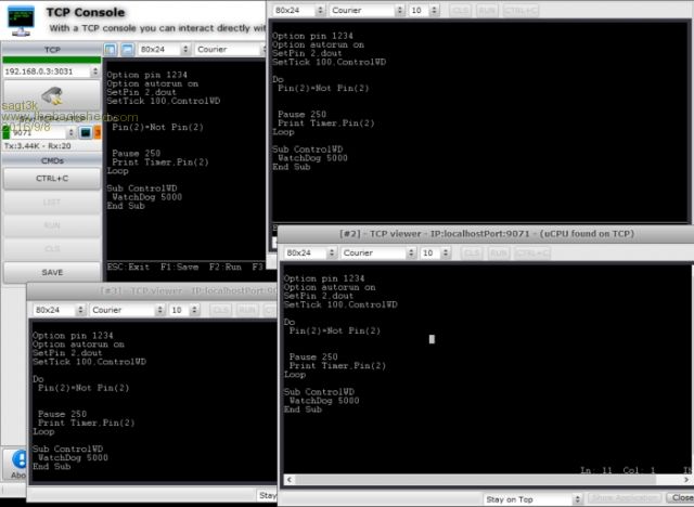

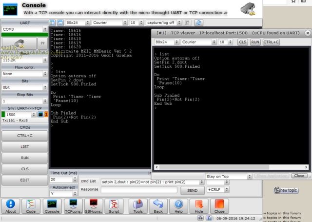

Hi
In this example I have a VT100 client console connected with the same software, but in other location/PC. Not only I could interact with the console directly into TCP, with the remote PC that has connected a micromite via UART , but I can interact via script and code to manipulate data etc.

Hi Chris
The SW is optimazed to interact in UART or TCP mode with all key sequence of Micromite.
I can have COMx with a Micromite and other multiple console with TCP ports.
In this example I have:
PC(192.168.0.3)+UART COM3:+Micromite, I share COM3 on TCPport:3031
My PC(x.x.x.2) is connected in TCPconsole with 192.168.0.3:3031
My PC share again port TCP x.x.x.3:3031 with another port 9071 and I have create another 3 TCPconsole on 9071 ...
Praticaly Micromite on UART3 on PC(x.x.x.3:3031)
and (x.x.x.2) share (x.x.x.3:3031) and redirect all data on port 9071 and so on ... etc..and scripts could interact both UART that TCP indifferently.

Thanks sagt3k,
From your description it sounds workable.
If there is any stub code running on the Micromite I should be able to create it fairly easily in GCBasic and if it is just VT100 syntax then a Few #Define statements will work.
My eye sight is not good and your images small so I can't really read the code in the screen shots, but I don't see anything special there apart from PIN 2 being output, and the Print Timer.Pin(2) statement.
I think it will be a matter of "suck it and see" (translation from English slang - Try it out and see if it works).
Chris
p.s. I should add that I realise that you are showing Micromite Interpretive BASIC in Console mode, whereas, GCBASIC is a compiler. I was looking to see if that code had any cFunction calls etc. to act as a protocol layer to talk to your software.Edited by Chris Roper 2016-09-09

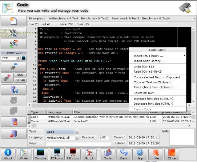

Hi Chris
The software has a built-in editor and recognizes all micromite or micromite plus instructions depends on the "Linguage" setting. You can directly write the code and then decide to send on the HW or via UART or via TCP. You, for example, could create a new record, capture the UART code, make changes and save on micromite connected in TCP. After can SAVE the code in the database/dat file. I often do this when I have to reprogram a Micromite remotely. With right mouse button you could insert code as "User Library" that you previously saved in the library, again via the integrated editor. The short idea is to create a service for CLOUD quick interchange of code with public/group or private profile as DROPBOX etc. but all managed by the SW.
Besides all the code you just created it has a unique identifier ID, which will allow you to save uniquely code (a kind of stamp) that will go on a server with email / data / code that will ensure the uniqueness of the code created by the owner. You will be able to decide whether to publish it and give the opportunity to share it

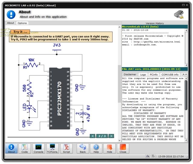

Hi to Everybody
I proposed to Geoff if I could give the name of "Micromite Lab" and to him it seemed like a good idea. Here are some pictures, as well as anticipated the software immediately will give the opportunity to newcomers from "About page" a quick look at "Micromite project". Then people coming in and trying, by reading the manuals (always integrated to the software), everyone will quickly write some code.
