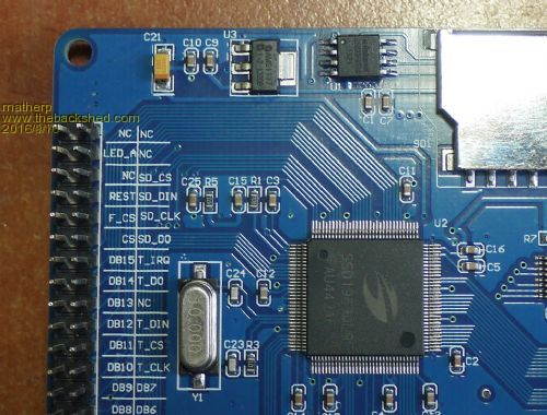

In this thread we developed code to use a serial flash chip (e.g.Winbond 25Q32) for some data logging activities.
These chips are particularly convenient because they can be mounted on the back of many TFT displays
For an application I'm writing I need to display some images but don't want to use an SD card for the runtime code so it seemed sensible to store them on the serial flash chip.
To do this I have written a program that reads an image off SD card and then stores it on the flash.
There is only one function:
storepic(1000,"leopardA.ppm")
This takes the image file "leopardA.ppm" and stores it from page 1000 upwards on the flash chip. The image file on the SDcard must be in ASCII .PPM format.
A 800x480 24-bit image file takes 88 seconds to write to the flash card and takes 4717 pages of the flash (a 32Mbit flash chip has 16384 pages). You can store as many images as there is space on the flash chip but it is your responsibility to make sure the pages used don't overlap. The storepic routine reports flash usage to help with this.
To display the picture there is a similarly simple function
displaypicture(1000,0,0)
1000 is the start page of the picture in the flash as defined in the storepic example command and the two zeroes are the x,y coordinates of the top left of the picture.
The displaypicture command only takes 2.7 seconds for a 800x480 24-bit image, much faster (5x) than displaying from SDcard.
The programs should run on any Micromite+ but note you need to uncomment the appropriate display CFunctions for 64 or 100-pin.
In both programs you need to define the MM+ pin that is connected to the F-CS connection on the display (see picture). Version 1A of the Explore100 ties this pin high and won't work - I haven't got a later version to test with.
The flash handling CFunctions are exactly the same as those in the logging thread with the exception that the read command has been turned from a subroutine into a function returning a string which is now possible since V5.2 of the MM+ firmware.

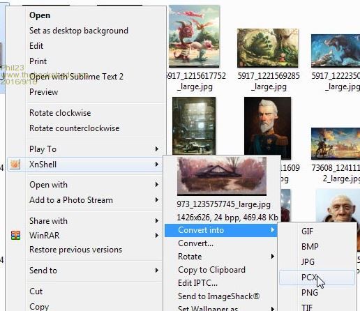

Phil23
Joined: 27/03/2016
Posts: 1667
Posted: 11:01am 16 Sep 2016
  matherp said  I use PaintShopPro V7.04 for all my file manipulation. Came out in 1999 but still works perfectly on W10 and I think is now available for free download
It's worth taking a look at XnView for basic file manipulation too,
for those who don't have something.
Freeware for personal use; No ads or rubbish.
It's like the ASCII programmer Vs MP Labs; Instant load Vs wait.
I've got various versions of PS & PS Elements on different PC's here, but with XnView, all the basic functions are just a right click of the mouse away;
instantly loads, & I can open, crop, resize & convert an image in under 30 seconds.
Supports over 500 formats, ppm ASCII included.
Full download with all features is 17Meg. It's on all PC's here and it behaves like a natural extension of the Windows Shell.
Right Click can add this to the context menu, if desired.
XnView.

Posts: 10056
Posted: 09:00pm 16 Sep 2016
[Quote=matherp]Version 1A of the Explore100 ties this pin high and won't work - I haven't got a later version to test with. [/Quote]
Yes, version 1A of the E100 board has the F_CS pin tied high with one of the internal layers of the board, so not really easy or practicial to hack one of those for the F_CS pin access. 1A is the prototype run of boards, so......
Version 1B or greater are the first production-run boards, and F_CS was brought out and pulled high via a 10k resistor, so you can get at F_CS in the later versions of the board.
