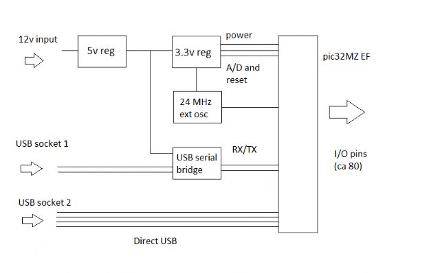

As something of an experiment, I modified my 100 pin pic32 sn-5x board,
to suit the pic32MZ pattern, as a pathfinder, but expected major changes
would be needed before it would be ok. It was rushed as I had to concentrate
elsewhere for a while.
BUT it is programming with a pickit3
and now running at 200 MHz (ed) (albeit with a simple Harmony led flasher) so far.
So the question is now, what software direction do you think ? Anyone with recent
experience of Harmony ? C++ perhaps? PLIB news ?Edited by chronic 2016-10-10

this is a test to see what simple png schematics display like..
eg sn-7x board overview :
