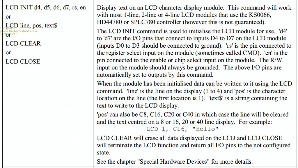

Quick question. I have a 4 line lcd I'd like to use instead of the standard 2 line.
Any trick to this? From what I've read it should be straight forward with the LCD command.
I'm just getting 2 blank lines at the moment.

On the LCD's, as per the standard manual, page 61:
Many four-line LCD's are setup in a 1+3/2+4 line arrangement - it depends on the controller chip used on your particular LCD.
Some LCD's will show the lines correctly exactly as per line1/line2/line3/line4, whereas others will show the lines as line1/line3/line2/line4.
In many of the four-line LCD's I have used, it is in the 1,3,2,4 arrangement:
1111111111111111
3333333333333333
2222222222222222
4444444444444444
So to put text on the start of "Line 2"(with all the '3' characters above, you would position the text at C17, line 1, as the data clocked to the display is in the form of:
11111111111111113333333333333333
22222222222222224444444444444444
Again, it depends very much on the controller being used in your LCD.

No need to be THAT careful.
Most LCD displays are like that - the 2x16 or 4x20 etc.
It does very much depend on the LCD controller in question though.
You MUST choose an LCD with a compatible controller to be able to use this command.
See details in the GIF image I posted from the manual.
