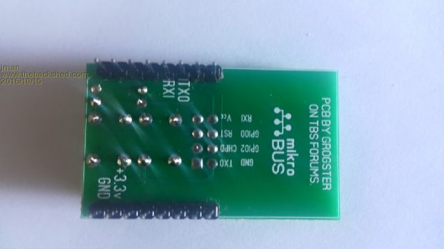

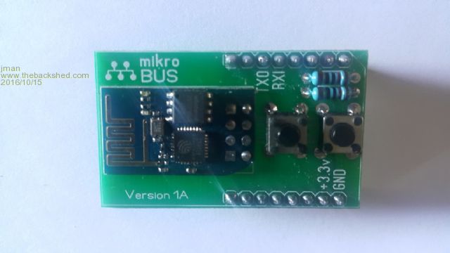

Hi
To make it easier to use WiFi with the E100 Grogster
kindly designed a PCB for me that uses the mikro BUS standard
to interface to an ESP-01.

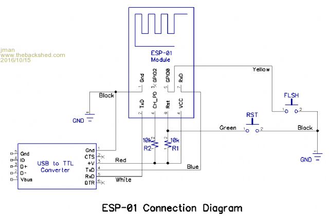

The buttons are to make updating the firmware easier
and can omitted if you don't intend to update the ESP-01
firmware. To update the firmware use the following circuit

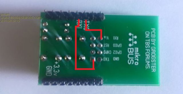

To use the module on the E100 you need to make the solder jumpers
labelled click TX/RX this uses COM3
Grogster will have the PCB's on his website soon these should be
around $1.00NZD
Enjoy
Jman

Posts: 12029
Posted: 09:12pm 14 Oct 2016
Nice idea
My only comment would be to add holes for a 100uF tantalum and 0.1uF ceramic across the power rails. The ESP is notoriously sensitive to power supply and works best with a big "tank" capacitor as close as possible to the module.
Posts: 10070
Posted: 11:30pm 14 Oct 2016
Version 1B?
You could easily add those caps on the bottom side I guess - there's plenty of room in between the female headers on the Click sockets, for the caps to exist on the bottom of this module.

  Grogster said   Version 1B?
- there's plenty of room in between the female headers on the Click sockets...
With all that room to spare, maybe Version 2 could support either ESP-01 or HC-11/12 modules, just by installing the appropriate header.?
