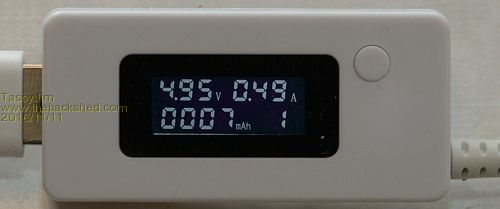

I don't think this one has been discussed here before.
Model KCX-017
I like the 0.5 second updates and the simultaneous display of voltage and current.
It also has an accumulated power consumed in mAh - not something that interests me but it might come in handy.
The display is nice and clear.
Internally, it uses a 358IC and 0.025 ohm shunt for current measurement.
A review:
http://lygte-info.dk/review/USBmeter%20KCX-017%20UK.html

Yes I've had one of these plugged in ahead of my USB-Serial converter for about six months now Jim - thanks for the review link. They market it as a charging (cumulative mAh) meter but I'm not quite sure of the point of that; I just find it useful to monitor the USB port voltage and current flowing out, and for the price it does a pretty good job.
The only minor gripe I'd have is that it 'only' displays current to 2 dec. places i.e. X.XX amps so the lowest draw you can see is 10mA. It'd be nice to be able to switch the range to see another dec. pt. but still, not bad for the price. Voltage displays to X.XX too and that's quite adequate.

I've used the accumulated power measurement to monitor both power used from a battery and output from a solar panel to see if I have a reasonable match between consumption and charge. It's been very handy and an easy way to check quickly what is going on.
