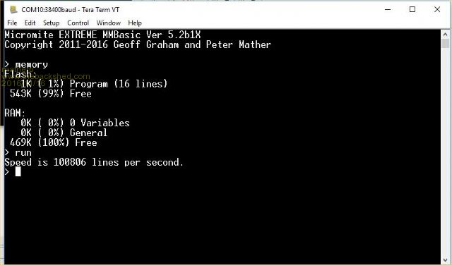

It had to be done
Attached, with Geoff's approval, is a hex file for the Micromite code V5.2 to run on a PIC32MZ chip.
The PIC32MZ runs at 198MHz and has 512K RAM. It also has hardware floating point and 12-bit analog to digital convertors. The MZ doesn't need a VCAP just good decoupling at each power input. Early indications are that MMBasic runs more than twice as fast as on the MX470 as well as having lots of extra memory.
2016-11-16_110646_MicromiteExtremeV5.2b1X.zip
All 5.2 Micromite Plus functionality has been included (i.e.including SDcard, USB etc.) and has been tested at various stages of development but this is a first beta so......
The code has been developed on a PIC32MZ2048EFG064 (huge thanks to Kiiid for the development board) but should work on a PIC32MZ2048EFG100, PIC32MZ2048EFH064 and PIC32MZ2048EFH100
Next steps are to integrate any new 5.3 functionality and bug fixes. Then I'm going to look at converting all floating point operations to DOUBLE using the power of the hardware floating point. Also the chip has hardware random number generation which should be used. Finally, the chip is capable of running a VGA monitor like the Maximite but getting that running in a Harmony environment might be tricky
The crystal required is 12MHz

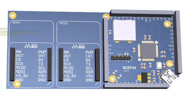

Good one Peter
I have a MZEF64 board (new revision) currently in manufacturing. Here is what it looks like (those grey things are actually headers, don't mind the poor render). And the schematic, which is based on the original MZEF64 which you have.
A full port of MMBasic NOT based on Harmony but on PLIB is done (credit to Spas for the huge volume of work on that port) and will be out to Geoff for approval in the next day or two.
2016-11-16_122945_MZEF64.pdf
