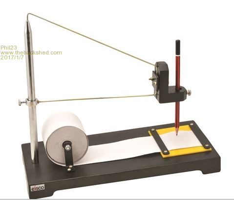

Just fished out Feb 2013's SC magazine to have a look at the Seismograph they published back then.
Curious about how it could be implemented with a Micromite.
The hardware is simple, just a case of whether there's a better alternative for the sensing side of things.
Would be something I'd like to have, if I lived over there, considering the last few weeks.
Phil.

Yes,
The mechanical bits look easy.
Just wonder what sensor alternatives there might be.
Accelerometer module on the moving arm?
Not sure how sensitive that would be.
3-axes-Analog-Output-Accelerometer-Module
Or maybe an magnet at the end and a Hall effect sensor.
Hall-effect-magnetic-sensor-module
Be nice if the circuitry was the easiest bit just leaving the mechanics of the thing & the code.
Phil.

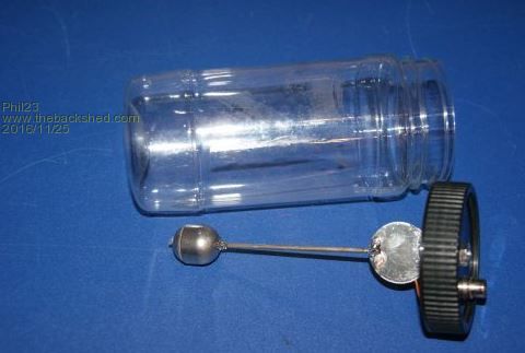

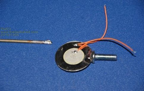

Food for thought regarding an easily built sensor...
Pretty self explanatory.
Phil.

Posts: 6624
Posted: 04:57pm 07 Jan 2017
The circuit in the original SC article is simple enough. Just replace the PICAXE with a 'mite of choice and a display.
The signals of interest are low frequency so the mite's analogue inputs will be plenty fast enough.
The 3 axis accelerometer should also work but I am not sure about their low frequency abilities.
It would be interesting to compare the sensitivity of the two methods.
It is something I nearly built when the article came out and next time the earth moves, I will wish I had.
Posts: 6624
Posted: 05:17pm 07 Jan 2017
I should have added that it is the movement of the earth we are looking at, not the pendulum so the 3 axis accelerometer is simply glued to a convenient lump of concrete.
That makes the hardware side of things easy!
