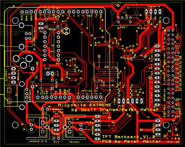

All feedback appreciated before I go to copper. I will of course post the gerbers as soon as I'm happy they are OK

Posts: 2994
Posted: 02:15am 26 Nov 2016
Looks nice, and really useful!
My comments/questions:
1> What are the mm dimensions of PCB?
2> The mounting holes look very close to 'things' - may not allow screw heads/bolts to be used?
3> Is there an onboard uSD socket - can't see one - but my eyes are going bonkers looking at this!
4> How many PCBs would you get made? I am happy to offer these as part/fully assembled - so possibly bring down PCB manufacture unit cost for you.
5> Could you send me larger format diagram to save my eyes?
6> How soon?
7> Any chance of a 100pin version too
WW

Posts: 12031
Posted: 07:10am 26 Nov 2016
100x80
  Quote  The mounting holes look very close to 'things' - may not allow screw heads/bolts to be used?
I've now improved this for at least three of the holes. The holes match the 3.2" SSD1289 display. Anything bigger breaks the 10x10 limit for v-cheap PCBs
  Quote  Is there an onboard uSD socket
No, the expectation is that the SDsocket on the TFT display is used and the wiring supports this

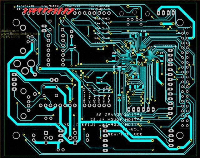

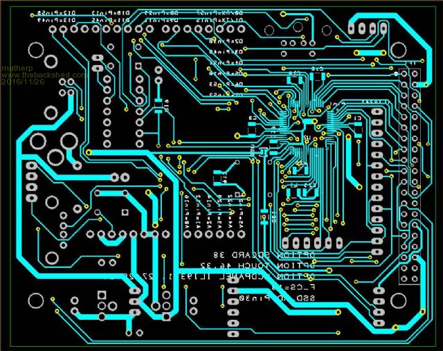

2016-11-26_170941_Bottom.pdf
2016-11-26_170953_TOP.pdf
How soon?
As soon as Itead make the PCbs
Not on the agenda at the moment. easy to mod the schematic but the layout on double sided takes forever.
Could you make the console a 5-way by adding a 5v pin?
DoneEdited by matherp 2016-11-27

Posts: 12031
Posted: 08:58am 26 Nov 2016
  Quote  Where is the oscillator located on you PCB?
You are probably looking for something small - it is huge (comparatively) big square box with 4 pins at the corners labelled Y1 on the top diagram
RS 796-0619Edited by matherp 2016-11-27
Posts: 2994
Posted: 11:53am 26 Nov 2016
Have you purchased all their stock? RS currently have none available
Sure did miss that Y1. What does the 'Y' prefix signify?
