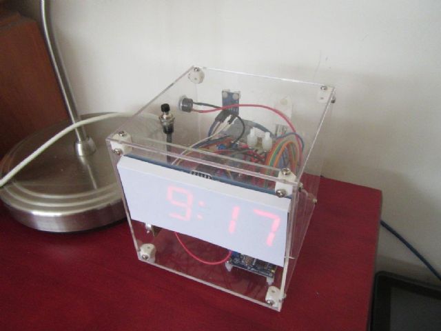

Project overview if anybody interested.
Bedside clock - I got sick of all the clocks in the house being out of time. So this one syncs to Internet time every 60 seconds over a CAN bus. And it has an alarm (just a piezo at the moment) that lets me know it's 6am on a weekday. Doesn't come on on weekends.
CAN bus is great for sensors - as long as you don't saturate the bus, you can send any time you like and the data will go through. The transmission automatically drops out if the driver detects another unit clashing with the transmission. No more master/slave RS485 arrangements - just send when you want to and if other stations want the data they can run with it... I use the same CAN bus to run our security system - PIRs send CAN packets whenever movement is detected in a zone. There is an Arduino interface module between the CAN bus and the Server - basically a CAN to USB Serial adapter.
So I threw in a few sensors:
1. DHT22 for temperature/humidity
2. BMP085 for pressure/temperature
3. Luminance to adjust brightness of display
All parts sourced cheaply on eBay.
I made box on laser cutter and fabricated the corner joiners on 3D printer (tapped them to M3 after printing). I use OpenSCAD for 3D modelling - a bit of a learning curve but fantastic and simple if you like programming.

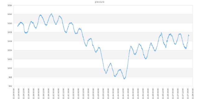

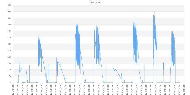

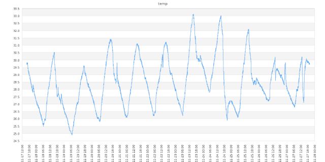

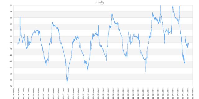

I'm logging the data to a MySQL database every minute. Here is the latest data which is available live to me via my webserver in PHP using JPGraph (I probably should adjust the bottom margin so you can see the full date). Will also move it over to a FLOT JavaScript chart at some stage too.

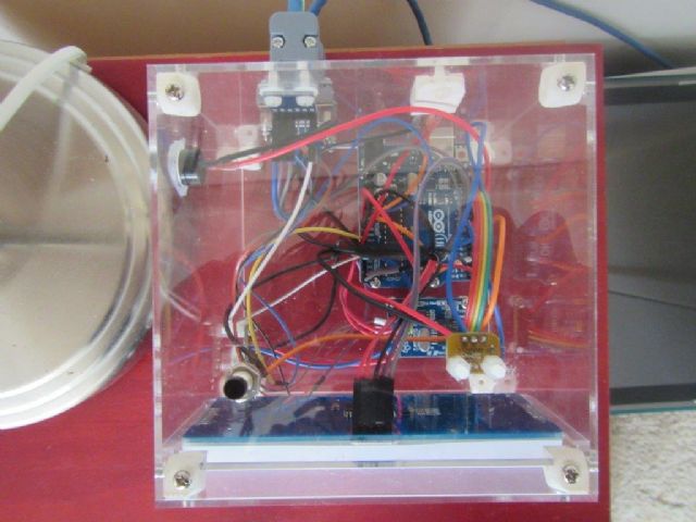

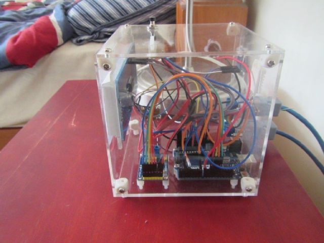

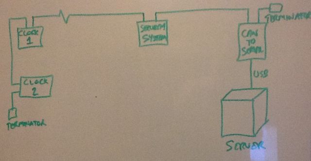

Here is a block diagram showing the basic setup of the units connected by Cat5 cable with DB9 connectors (in and out on each unit):
The total run is about 30 metres I guess and carries 12V power as well as the CAN bus on a single Cat5 cable.
Good spotting Grogster - yep, all driven by Arduinos with an SPI MCP2515 based CAN Bus Module that uses a TJA1050 transceiver. Not bad for $2.86 including delivery:
MCP2515 from eBay
It would be very easy to set up a similar system using the Micromite.
I'm using the Freetronics Light Sensor Module for reading luminance at the moment. All the sensors are installed inside the box but I laser cut openings for each of them to protrude through (apart from the light sensor which sees through the clear acrylic).
Happy to share more details if people are interested - just ask!

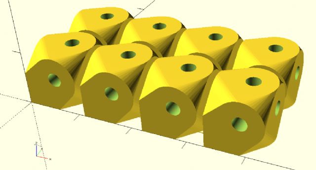

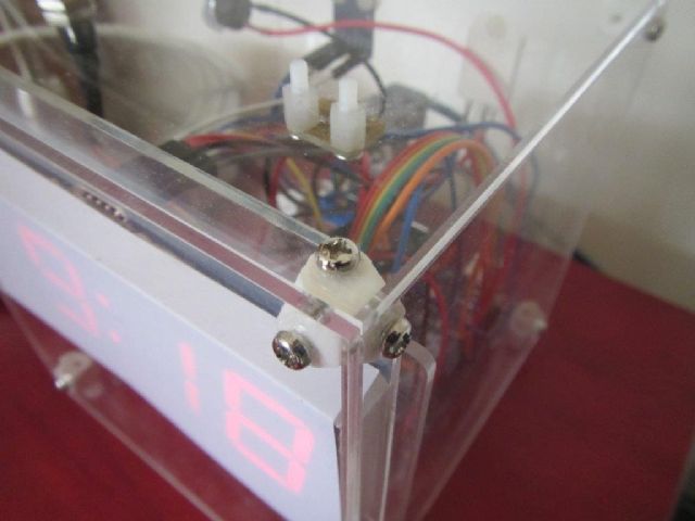

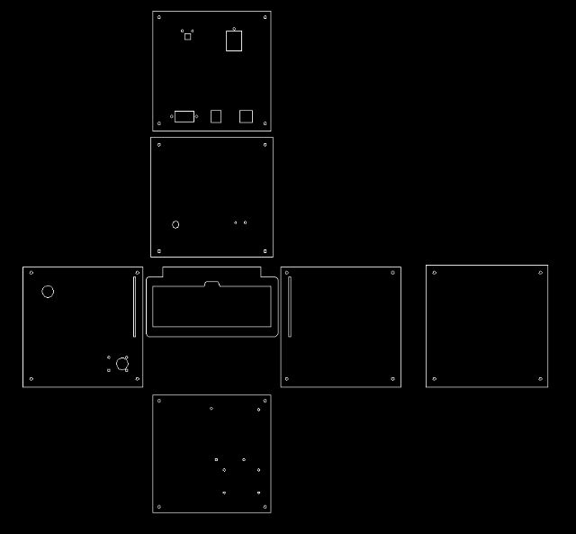

Here are the laser cut parts:
And the corner brackets that I 3D printed then tapped to M3 thread:
Here is the OpenSCAD program I created that produced the 3D model for these brackets:
fineness=50;
holein=6;
od=8;
id=2.5; // 2.5mm = tap size for M3 x 0.5mm thread
or=od/2;
ir=id/2;
depth=10;
translate([depth*0+0, 0, 0])
bracket();
translate([depth*1+1, 0, 0])
bracket();
translate([depth*2+2, 0, 0])
bracket();
translate([depth*3+3, 0, 0])
bracket();
translate([0, depth*1+1, 0]) {
bracket();
bracket();
bracket();
bracket();
translate([0, -2+depth/2, 0]) cube(size=[depth*4, 0.1, 0.1]);
translate([0, -1+depth+depth/2, 0]) cube(size=[depth*4, 0.1, 0.1]);
translate([-2+depth/2, 0, 0]) cube(size=[0.1, depth*2, 0.1]);
module bracket(){
difference(){
hull(){
translate([holein,0,holein])
rotate(a = [-90, 0, 0])
socket();
translate([0,holein,holein])
rotate(a = [0, 90, 0])
socket();
translate([holein,holein,0])
socket();
translate(0.01,0.01,0.01)
cube(size = [holein, holein, holein], center = false);
hole();
hole();
hole();
module socket() {
cylinder(h=depth, r1=or, r2=or, centre=false, $fn=fineness);
module hole() {
translate([0, 0, -1])
cylinder(h=depth+2, r1=ir, r2=ir, centre=false, $fn=fineness);

And of course the large 7 segment LED displays (I2C) were from eBay also at about $13ea.
They were a bit bright for my liking even on the lowest dimming setting so I put a piece of paper between them and the acrylic front of the box. Not a very high-tech solution, but it works!
