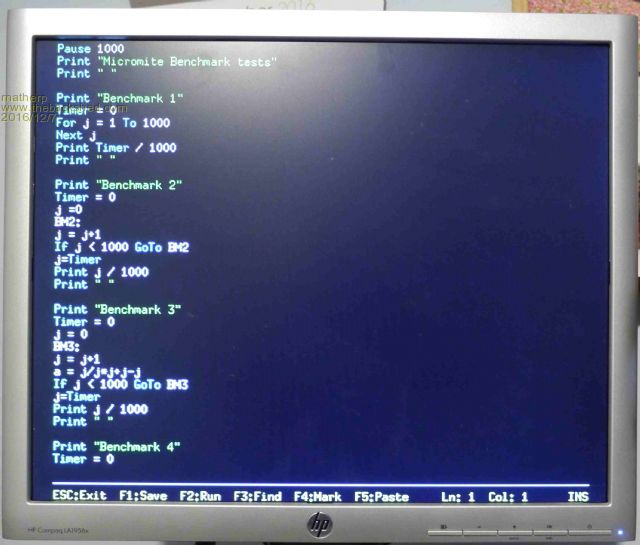

This release includes full 640x480 VGA capability for both the 64 and 100-pin MZ parts. Note this requires a 24-MHz oscillator and going forward I will only be supporting 24-MHz oscillators for the EXTREME as these give full 200MHz capability. If you have a PCB with a 12MHz oscillator these can be easily swapped with a heat gun. I used RS part number 667-6338.
2016-12-07_155919_MicromiteEXTREMEb5v6.zip
use:
OPTION LCDPANEL VGA
to enable the display, then
OPTION LCDPANEL CONSOLE 1
will give a 80x36 line display for the console with full colour editing capability.
All Micromite-PLUS drawing and GUI commands are available as per a TFT display
On the 64-pin part only SPI2 is available for general use (including SDcard) if VGA is enabled.

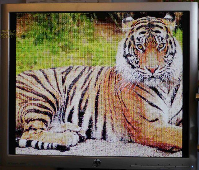

Attached is a photo of our friendly tiger converted to RGB111 using XnView set to do 8-colour Bayer dithering displayed using the VGA driver. Loading the image takes just under 1 second.
2016-12-08_114326_tiger640.zip

Love the 'dithered' Tiger - hope to see it here later on my monitor once I've built the VGA circuit, and sorted an appropriate vga lead.
