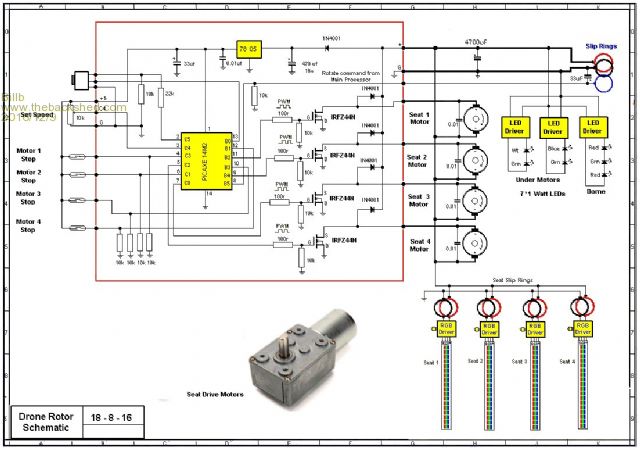

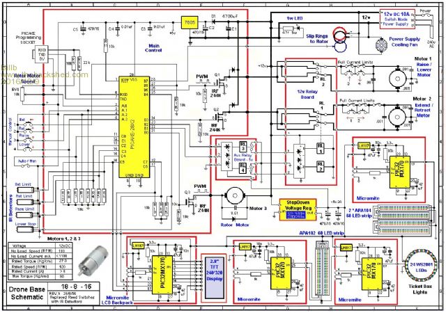

The new addition is the DRONE ride. This is controlled by a picaxe 28X2 as the main controller with a 14m2 controlling the
operation of the seat rotation.
Also there are four PIC32MX170s controlling the LCD and strip LED lights.
One LCD backpack and 3 of BigMicks 170 boards.
All up there are three high torque 12v motors and four worm drive motors for the seats.
https://www.youtube.com/watch?v=XrBXMeq9stg&t=3s
Shematics of the Drone
