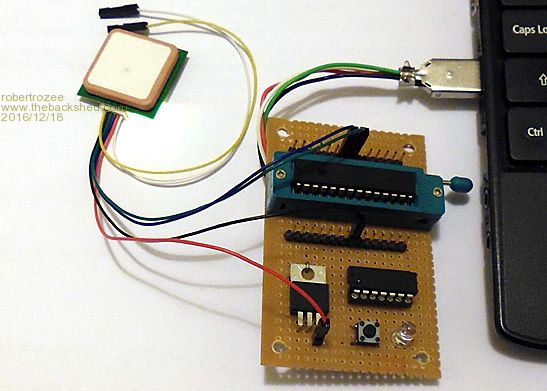

hi,
below is a small demo showing how to achieve the following:
1. configure a SiRF chipset to output a single NMEA sentence repeatedly
2. implement serial input using an interrupt, data saved in a circular line buffer
3. use VT100 codes to clear screen and position cursor
4. extract comma delimited data from a string
NMEA sentences from the GPS are terminated with CR+LF, and this pair is used to split up the data stream into individual lines. up 9 lines can be held in the circular line buffer before it overflows.
the SiRF chipset can be configured with static navigation on or off. when turned on, static navigation attempts to eliminate 'wandering' causing the appearance of false motion. in general, it does this poorly, and so by default the below code turns static navigation off. the SiRF3 default is for it to be turned on.
rob :-)
