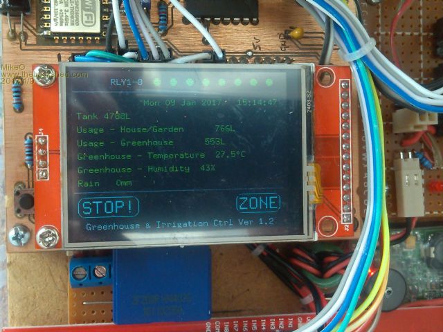

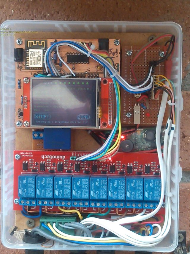

Just commissioned my latest project , this one is set up as a an irrigation controller for the Garden and Greenhouse but it could be used for other timed repeatable tasks.
Mine has timed tasks for 2 garden areas and Greenhouse, misting for greenhouse, Exhaust fan for greenhouse, 2 water flow sensors and 10000 ltr tank level sensor.
Timed tasks can be up to 5 On/Off cycles per day/area, days of the week etc.
Total water usage monitoring, usage per day exceeded per day will trigger override.
Configuration Set up is via Wifi , sent by complete file or by single line.
Sample config file.
1,Z1-Bed.1,W,1,0123456,08:00,08:05,09:00,09:00,09:00,09:00,09:00,09:00
2,Z2-Bed.2,W,0,0123456,00:00,00:00,09:00,09:0
3,Z3-GH.Tank,En,
4,Z4-Spare.1
5,Z5-Spare.2
6,Z6-GH.Water,W,1,0123456,00:00,00:00,12:58,13:50
7,Z7-GH.Mist,,30,30
8,Z8-GH.Fan,En,30,27
9,Usage Greenhouse-House and Garden,0,0
10,Max Daily Usage,500

That is very impressive, good job!! Is that some loose pins I can see in the bottom left hand corner of the first pic?? If it is you might want to get them out of there, would hate to hear you had a short and ruined some of that great work.
MikeO
Joined: 11/09/2011
Posts: 275
Posted: 09:15pm 08 Jan 2017
Jim I have tested down a 90mm pipe and was able to measure at 600mm quite accurately. Yes you need the waterproof (they are actually car sensors) type as you will find lots of condensation ends up on them.
Busa, Yes they were hangover from during testing, some tidying up to do! Thanks.
