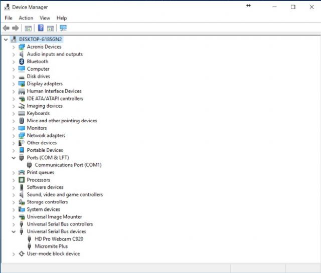

I'v e just flashed my Explore 100 with 5.3 but the computer can't find a serial driver for it
Is there any driver I need to download for this?
The board was working fine with V5.2
The computer only finds com1 which isn't the E100
Edit: I agree with Phil - put a donate button on the site please you do amazing work Edited by lew247 2017-01-14

Hi Lewis,
I am doing exactly the same thing now. I had to use an external 5v PSU (remember to remove J1), and all works fine.
BUT if the TFT is unconnected then it appears 'dead'. I think this is something to do with lack of a T_IRQ pull-up (something I was discussing with PeterM recently).
Stay tuned - I may have updates later.
BUT I can say there are no extra drivers required.
WW

Thanks Phil
I've always used the 5V psu, I prefer not to rely on usb power
Unfortunately its not worked on mine, and removing the display does nothing either, it just wont assign a com port
Posts: 2991
Posted: 09:00am 13 Jan 2017
Lewis,
Just try re-flashing first, then with TFT connected, run through the OPTION setup.
