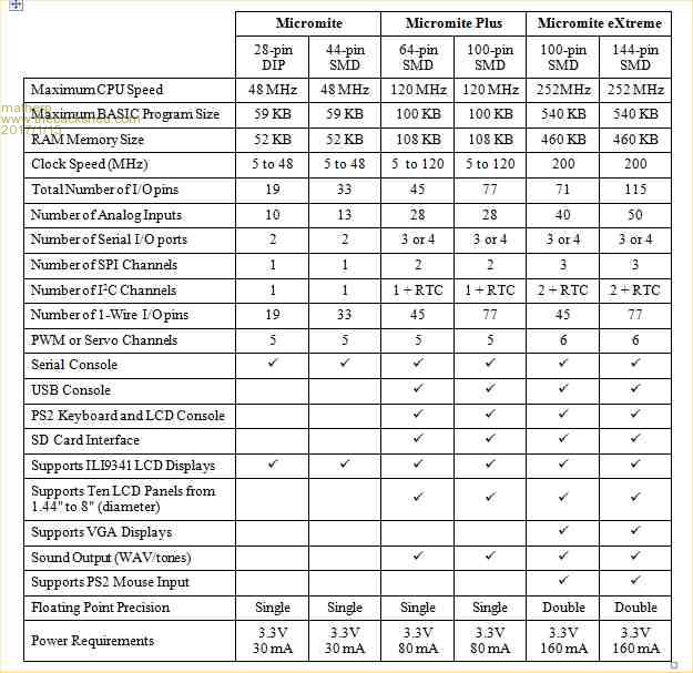

after 6 Months with no MMbasic iam back and confused about Hard and Software for and with Mmbasic.
i read much about new Boards and the new MZ chip but it is frustrated to read and search so much to become an Oversight for.
is it possible to become an extra Topic for Mmbasic and his Hardware .
i think the hard and software has so much Variants and new Members have problems with.
thx
Posts: 10070
Posted: 03:37pm 14 Jan 2017
VERY simply:
MM2 28-PIN: For simple tasks, and entry-level stuff, and for initial learning about MMBASIC and teaching yourself the language and how to use it. Very cheap, and will run on batteries. Ideal for classroom experiments with it's DIL size. The only MM available in DIL package - all the other versions are QFP SMD packages.
MM+ 64-PIN: For more advanced tasks, most notably for anything requiring a MM automated GUI or SD-CARD use or any high-speed parallel LCD use.
MM+ 100-PIN: Same as above, but if you need more I/O pins.
MMX 144-PIN: The highest spec, fastest, most powerful version, with the most features and advantages of the entire series of MM chips(currently). Used when you need speed, features, GUI, SD-card, Touch, music playback etc ALL at the same time.
As I say - that is very simply, but hopefully will allow you to choose your chip a little more easily.
You do make a good point - now that there are several versions available, it can be confusing for newcomers, so I agree that another thread needs to be started to explain in more detail, the differences between them. "How to choose your Micromite chip" or something like that.

Peter, the matrix is exactly what has been needed (very well done), and I would suggest including this in each of Geoff's MM manuals. Showing the complete range up to the eXtreme even in the manual for the basic 48 MHz MM.

  Quote  Peter, the matrix is exactly what has been needed (very well done),
Not me, Geoff was the author, I just copied it from the Micromite eXtreme manual

+1 for the chart from me too, thank you again Geoff and Peter.
I think a row in the chart showing the current version of MMBasic would be useful too, especially for the Maximite and MX150 versions. The versions for the MM2 and later ones could have an asterix to note: "still in active development; check Geoff's website for updates" or some-such.
Also the manuals that are relevant to each would be a handy addition, these have changed a fair bit - I mean mainly the name + necessary additions like the Hardware and Addendum manuals.

The "spreadsheet" picture great. It looks like a spreadsheet or is it a table in in the PDF manual?
Is it possible to get a spreadsheet copy of this for download, then extra custom details can be added by the user.

here is a .ods spreadsheet of the data, with columns added for mono maximite and colour maximite. a note at end giving MX150 RAM and flash specs.
some details still need filling in, and i suspect the numbers for 1-wire pins for MZ2048 devices are wrong.
actual current consumptions for devices at different clock rates would be useful if anyone cares to perform a few measurements.

Just a note, as I have been compiling a list for the extreme 100 (I am looking at doing a MuP-ex100).
The extreme in the table above lists 71 IO pins.. From the table I have it `can' be 75 if PS2 k/b and Mouse is not required. So I suggest it be amended to 75.
For those interested here is the spreadsheet I have done for the 100pin extreme
