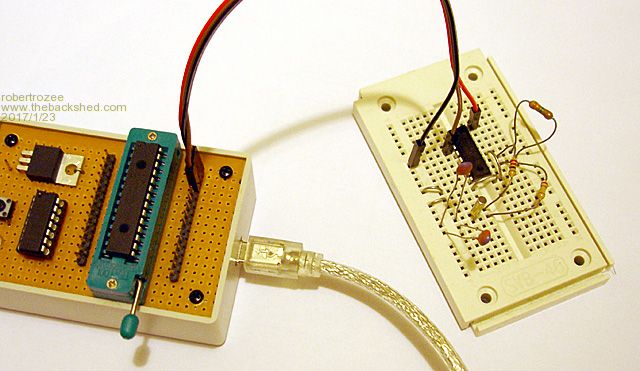

for quite a while i've been thinking about automatic trimming (disciplining) of the cpu clock on an MX170 micromite using an external crystal reference. this might take the form of the 1Hz output from an RTC module, or be derived from the 50/60Hz mains, or (in my case) obtained from a 32kHz watch crystal attached to a CD4060 ripple counter that generates a 2Hz output.
the big advantage of this approach, over simply using periodic calls to RTC GETTIME, is that frequency measurement, PWM, and other cpu clock dependant functions are also trimmed.
with the 2Hz signal from my CD4060 hooked up to pin 26, i used the following piece of code, implementing a crude proportional–integral control loop:
SetPin 26, inth, trimISR
Print count, Str$(E,3,2), Str$(I,3,2),, trim, Time$, Timer
Do: Loop Until flag
flag = 0 ' comment out this line to consume computrons
trimISR:
count = Timer Mod 500
E = 250 - count
I = ((I * 0.8) + (E * 0.2))
trim = Fix((E * 0.3) + (I * 0.7))
If trim < -31 Then trim = -31
If trim > 31 Then trim = 31
Option clocktrim trim
flag = 1
IReturn
thr results were surprisingly good, with extremely quick convergence to a stable state, although the loop stabalized at values around 256 (in my case) rather than the target of 250. this doesn't really matter, as long as it is stable:

commenting out the line containing "flag = 0" creates a little jitter in the calling of the ISR, with the result of the trim values wandering just a bit (between -4 and -7 in my case), but still quite acceptable stability.
here is the setup used:
note the use of a 270k series resistor for the crystal, and 3M3 biasing resistor; i've read that one needs to be careful to not over-drive 32kHz watch crystals as it is quite easy to damage them.
