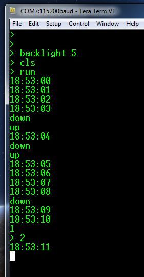

I wanted to check this with everyone, because it's probably something stupid I am doing.. But, maybe not.... I finally got some playtime in Sunday with the new beta code (v5.3B10) and was starting to build a simple setup screen for the RTC...
The Car facts:
I am running on an E-100 board with the RTC module installed in back. I have a SDD1963 based 4.3" LCD, passing all tests, touched calibrated with click sound, SD card pushed in and confirmed working...

This where I got so far...
Now, when I run this, I get whats expected on the time_display_box object...
I touched a blank area of the screen to generate a few pen "down-up" events..
So far, so good...
Then I touch the yer_val_box and enter the new year data.. I hit the "Ent" button and get what I expect back into yer_val_box...
But then I notice the interrupts are no longer working...
Humm... Now, it took a few tries and head scratching, but, I finally noticed it..
In this "snip" pix, notice the "command prompt" ..
Yep, the program is still runing ok, but, the firmware has returned, and (not shown here), you can type commands and the firmware answers back, AND the yer_val_box is still active and working too..! However, the rest of the INT subs are no longer active... Not sure whats going on here..
The program should stay trapped in the Do loop...
I can continue building, but was wondering if anyone else have seen this behavior..?
But, maybe it's just something stupid I am doing..!
BTW - What is the correct numbers to enter for the GETSCANLINE function..?
Thanks for any feedback on this stuff..!!

But... I didn't press control C..!! It just "shells out" on it's own...
The only thing that gets things back to working, is to type "edit"..
Then, the GUI stops and after exiting, things are back to normal...

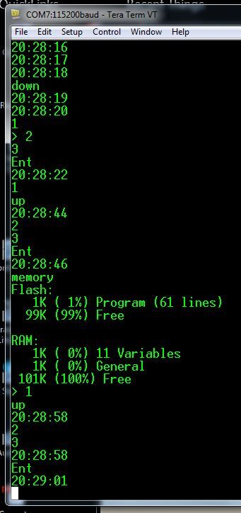

Posts: 6624
Posted: 06:30pm 23 Jan 2017
I can repeat the error on a Explore64 with 5.3beta3
When I bring up the keypad I can move between the ALT and normal screens.
If I press on "CAN" caption gets the value of "Ent". That doesn't seem right.
After printing the value of caption, the program exits with the following error:
15:07:39
Ent
[35] Loop
Error: FOR with misplaced = or TO
There are NO FOR's in the program at all.
If I press a number on the keypad, the main program exits to the command prompt without any error message.

I loaded the pump control demo program from the manual.
It runs OK
I added this to the end:
  Quote  SUB MM.KEYPRESS ref AS INTEGER, caption AS STRING
IF ref = nbr_hi AND caption = "Ent" THEN
IF VAL(CtrlVal(nbr_hi)) > 20 THEN CtrlVal(nbr_hi) = "20"
ENDIF
END SUB
The main program now exits like in Zonker's program and the GUI elements keep running.
The MM.KEYPRESS sub still runs as if it's a library function.
