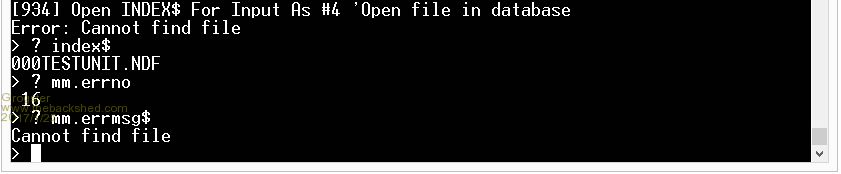

Hi folks.
MMBASIC 5.3B10, on 64-pin MM+.
I am getting this odd message:
The error message is correct, the error code is not.
The MM is correct in that the file does not exist.
MM.ERRNO #16 is a flash memory write failure, according to the advanced manual, page 39.
I would have fully expected MM.ERRNO to be 6 in this case.......
Has anyone seen this before?

I'm not sure what is going on here - it certainly does not sound right. I will add it to the list.

OK. Were you - or anyone else - able to reproduce that error?
