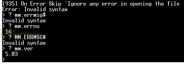

Posts: 10072
Posted: 11:08pm 29 Jan 2017
I am seeing this error too, whenever I try to use ON ERROR SKIP. Following the initial error, I also am not getting any response from mm.errmsg$:
MM.ERRMSG$ is suddenly "Invalid syntax", when it was perfectly valid BEFORE the on error skip error comes up. The MM.ERRNO value is also wrong, but Geoff knows about that one.
I'm using 5.03B10.

Posts: 10072
Posted: 01:21pm 30 Jan 2017
I need to correct the above - it was actually correct in terms of my asking MMBASIC in immediate mode(command prompt) what mm.errmsg$ was - it was indeed "Invalid syntax" - that was the error message last reported, so my asking for ? mm.errmsg$ and it reporting back "Invalid syntax." was actually correct in terms of the error message itself.
The message is wrong for the On Error Skip command, but the actual message text as held by mm.errmsg$ is correct, and asking to print that at the command prompt is actually the correct result for that command, if you see what I mean.....
Posts: 10072
Posted: 01:52pm 30 Jan 2017
UPDATE:
On Error Skip MUST specify the number of lines to ignore errors in - see B10 manual, page 63. Although the manual says that if you DON'T specify a number, it will default to one, this causes the error.
If I use On Error Skip 1 for ignore any errors in the next line where I try to open the file, it works perfectly, and even the mm.errno number is also then correct - 6 - which is file not found, which is exactly right.
The bug would seem to be connected to On Error Skip if you DON'T specify a number to skip, and MMBASIC is supposed to ASSUME one, but does not, and this is upsetting it.
Rob - I would be extremely interested to hear from you if this also fixes your issue with the same command.
