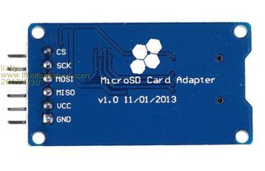

@Lizby, Just had a thought, is what you have something like this? If so are you running it from 5v or 3.3v as this one has a regulator and also signal voltage conversion between 3.3 to 5v , I am wondering if you are having issues due to this possibly?
Edit: I think this drawing will be near to what you may have. I could be that the level shifter on the data out MISO may be marginal for the uMite which maybe why you can't read the files. You could try some mods to the adapter as in this drawing. Really you don't need the level shifter or reg at all.
Mike Edited by MikeO 2017-02-02

I got the PM. Was able to snip the legs of the regulator and solder a link between IN and OUT. Could even re-install it if needed. Lifting R4 was trickier. That speck of dust will never go back in. Soldering the link between D0 (SD pin 7) and MISO was really beyond my skill level, but I think I got it with very fine wire.
Still no joy, though. It now says
>RUN
matherp's sd test
[21] SDcard opendir,""
Error: Not Ready
Doesn't print the directory as before.
So I'm ready to give up on this module. What do you use for your SD device?

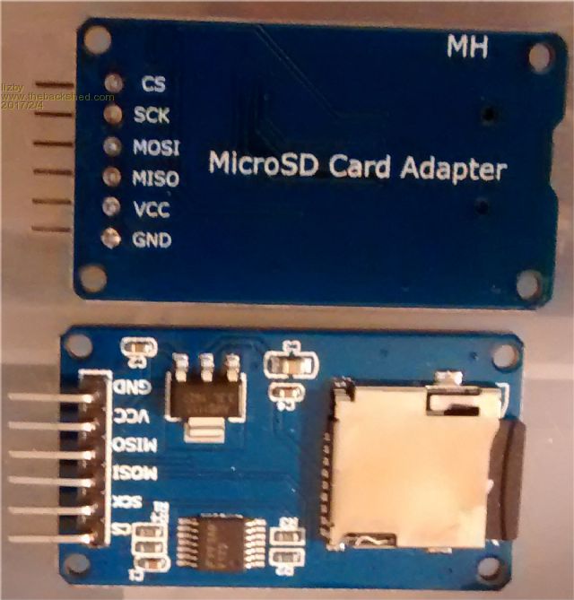

Posted: 03:44am 04 Feb 2017
Thank you for your interest.
Not much of the code can be said to be mine. The sdtest.zip file contains your sdtest.bas with a print line added, and library.bas, which is the code provided by MikeO, including your hex program (plus CFunction CPUSpeed from the MMBasic manual so I could test that the library was loaded properly).
This is the ebay sd module (with 3.3V regulator):
2017-02-04_134257_sdtest.zip
Running V5.2 on an MM-28 on bigmics MuPv3 board.

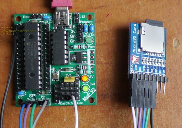

I've just run your code on both 5.2 and 5.3 using a MuPV3 and it works fine using the Waveshare SDcard adapter. I've attached a copy of the test empty file just for completeness
2017-02-04_145659_empty.zip Edited by matherp 2017-02-06
