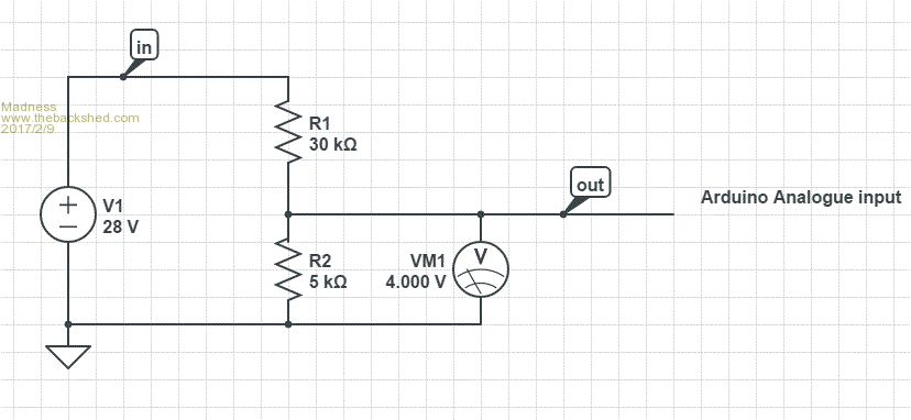

I am starting this thread to help gpalterpower build an Arduino based device to switch his hot water heater on and disconnect a grid tie inverter when the voltage is getting too high on his solar battery bank.
Here is a list of parts that are required, these are from suppliers that I have chosen after a quick search of AliEpress, you may find better quality and or cheaper if you do enough searching.

I think that is everything, this includes the voltage regulator to run it off the battery bank voltage. Only hardware change needed for different battery voltages is 30K resistor.
12V 15K
24V 30K
48V 60K
What we are setting out to do is turn on the SSR at a preset voltage in the Arduino to turn the hot water system and then at another slightly higher level turn off the GTI Inverter that is back feeding charge into the batteries via the DC off grid inverter. This can be programmed for any voltage level and also will include time delays for turn off and to turn back on to avoid rapid switching.
Using an SSR will also allow the ability to use pulse width modulation to turn it on and off rapidly at a controlled rate to regulate the battery voltage at a set level rather hard on or off and causing voltage fluctuations.Edited by Madness 2017-02-10

Here is the first part of the circuit

Okay here is the full circuit diagram, hopefully there are no mistakes.
This should all fit on the prototyping shield as per post 1. However the 2 SSR's will be seperate and you will need to allow room for a heatsink for the TIP35c.
I will also include a Serial 2X16 LCD display in the code, but it will work just the same with no display.
I will work on the code and then it will be ready to use when you have built the PCB.
I have made a PDF of the circuit that wil be easier to read.
