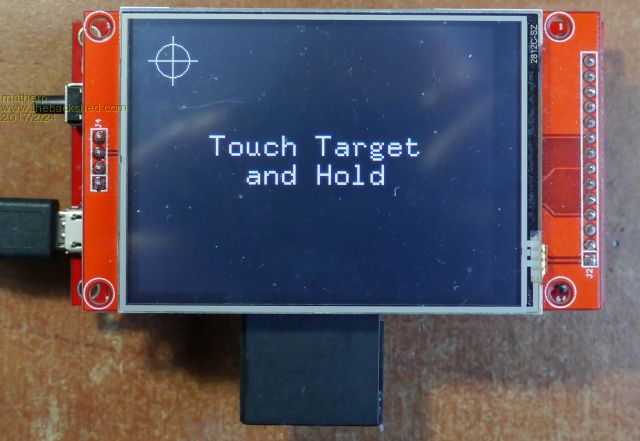

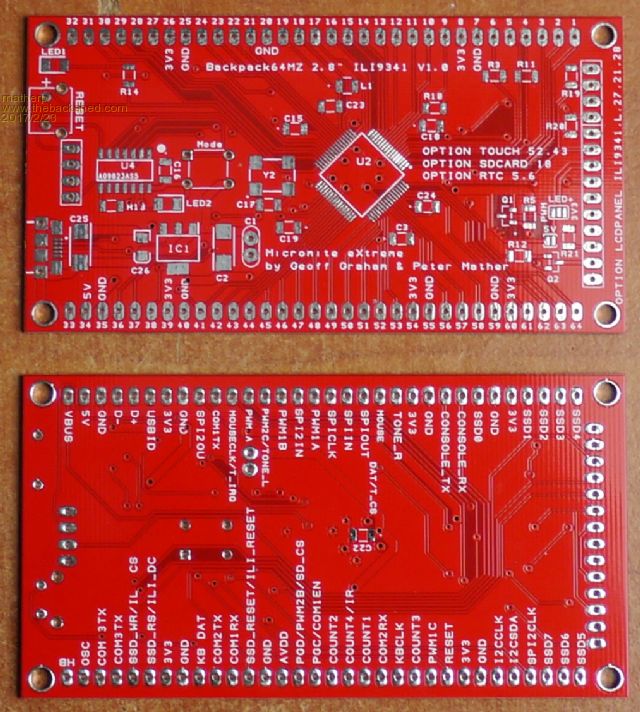

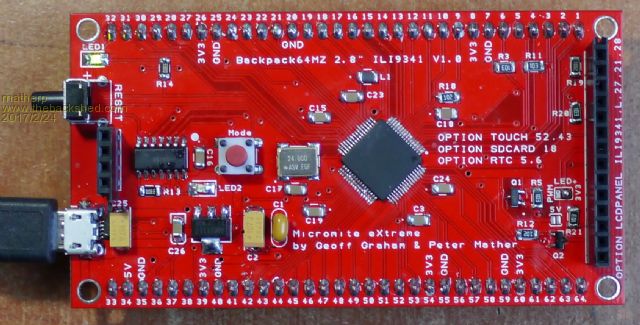

The question is what sort of PCB would suit? I've designed a 2.8” ILI9341 sized board as above and the prototypes of this are on order. Hopefully WhiteWizard will add this board to his portfolio but I'll release gerbers as soon as the design is checked out. Because the PCBs are comparatively small (93.5mm x 50mm) they are also cheap - USD23 for 10 including shipping to the UK.

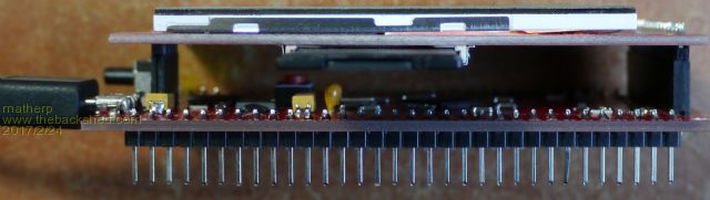

The board is powered through the micro-USB connector which also acts as the console via a PIC16F1455 with the USB/UART/Programmer code installed. The PCB is on a 0.1" grid and can be plugged directly into a breadboard for connecting additional components. The 2.8" ILI9341 TFT display, if fitted, mounts over the top of the components on the board and provides the SDcard slot. Every pin on the 64-pin MZ is broken out in the expected order. The bottom of the PCB is silk-screened with full details of the special function uses of each pin as below.
Other than the console, there is no on-board functionality provided except for transistors to allow for PWM control of the TFT backlight.
SMD components are chosen to be easy to hand solder (1206, SOIC, 7x5 oscillator).

Can wen have complete pins list? I don't see from 33 to pin 40.
I have PIC32MZ2048EFG064/PT, I need always active oscillator 24mhz ..right?
sagt3k
Posts: 12032
Posted: 11:56pm 11 Feb 2017
  Quote  I have PIC32MZ2048EFG064/PT, I need always active oscillator 24mhz ..right?
Yes
  Quote  Can wen have complete pins list? I don't see from 33 to pin 40.
These are USB and power pins see attached manual and PIC32MZ datasheet

Posts: 2552
Posted: 02:30am 12 Feb 2017
peter, you may wish to add a 10k pullup on the 1455's select input. i've found this necessary when using certain small/cheap SMD switches to prevent 'chattering' when the button is pressed and held down to reset the micromite. presumably weak pullup + dodgy button = pin 4 hovering mid-rail for too long and causing problems.

Posts: 12032
Posted: 12:53am 23 Feb 2017
PCBs have arrived - just need to build one now

Posts: 12032
Posted: 05:32am 24 Feb 2017
I like it when things work first time and don't need any changes
Contact WW if interested in a PCB
