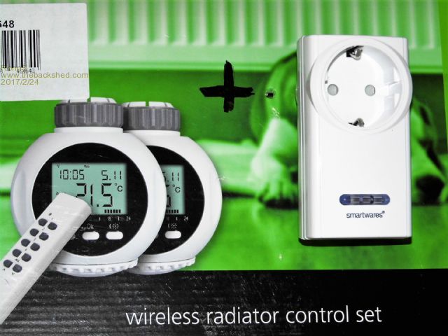

Hurraaa I finally got it to work (first steps)
this is the begin of my or our Micromite controlled "Smart Home-System"
My vision is a Micromite to control all my home radiator valves, switching and diming Lights and others
first ab very big thankyou to Peter Mather for his BitBang-CSub
the details:
i choose the 433,92 Mhz System there are cheap transmitters and actuators available
needed parts:
1) a SMARTWARES Radiator Valve
http://www.homewizard.co.uk/smartwares-wireless-radiator-valve.html
2) a 433,92 Mhz Transmitter
http://www.watterott.com/de/RF-Link-Sender-434MHz
3)a 433,92 Mhz Reciver
http://www.watterott.com/de/RF-Link-2400bps-Empfaenger-434MHz
4) a cheap Generic USB Saleae Logic Analyzer, China clone for about 6 dollars
and as software for windows : "pulseview"
https://sigrok.org/wiki/PulseView
so you can start it
the Smartwares Valves use as Transmitting Protocol a Protocol named "Arctech-switch"
You can find more details here: https://wiki.pilight.org/doku.php/arctech_switch_v7_0
see this site for fourther informations
many hours after work i used to read this and messure Pulse , test it and do this again till it works
With the following test program I reached on and off the valves

hello..the news:
now I can control these two units
and i took deeper look at the Arctech protocol so i found thats only one line of code needed to change the Status and the unit-number
i have made a little usable code ( Micromite 170 28 Pin) under use of Peter Mathers bitbang CSub -
That makes everything a bit clearer and I commented the bits to be changed
