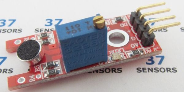

I'm using the Micromite and attempting to use both a "microphone" sensor to detect sounds. Nothing specific, but I'd like to trigger an LED if any sound is detected. Also I've acquired a programmable RGB strip.
Is there any code examples I could read over for either of these?

If it is one of these sensors:
There is a digital output on the sensor. This is a threshold output that is adjustable by the potentiometer on that board. That would be usable as an input to the Micromite.

Posted: 07:22am 21 Feb 2017
Mine doesn't have the adjustable pot.

Posted: 08:44am 21 Feb 2017
You might sample the speaker signal (use an analog input), perhaps every 200mS, and look at the level of the signal over a specific threshold.
You could even use another analog input and a potentiometer to make an adjustable threshold level.
