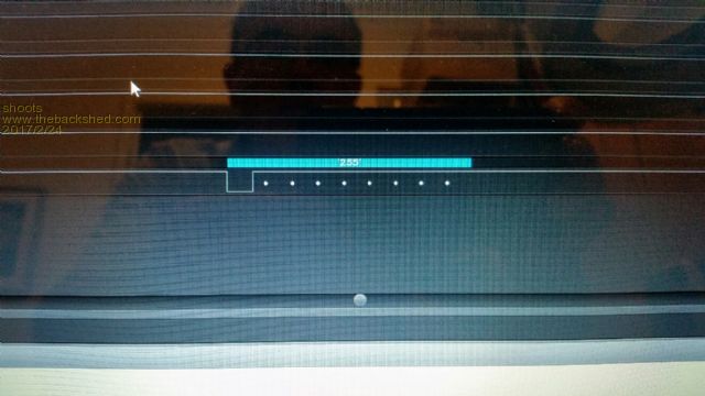

I fed the output through a CP2101 to real term and get a FF every cycle.

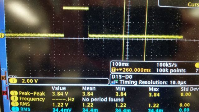

The output of pin 21 registers a pulse on the cro
from cro:
From the data analyser:
Any suggestions please?

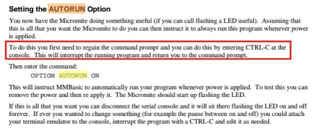

Several things need to be sorted out.
First, option autorun on is a command line statement.
You do not put that command into a program, why..?
Because it changes the behavior of the microcontroller when it "starts up".
As such, it is a flag that is written into an area of flash memory.
In the Micromite manual, on page 47 shows the "startup" behavior of the firmware.

Refer to Appendix A. You should be setting up the com port near the top of your program only. When done, the firmware setup a section of Ram to act as an "interrupt" driven serial data capture system. you don't even have to close it if you don't want to, but if you do, I wouldn't be doing it inside the Do Loop, although, I guess you could.
I think what is happening is this. You chouse a rather "slow" baudrate and you end up closing the com port faster that the time it takes to "trasnsmit" your data packet out of the transmit "buffer. Remenber, it is an "intrupt" driven system.
There are commands you can use to "ask" if the transmit buffer is empty..
So, make those changes to you program and it will then work correctly.
I would choose a higher baudrate and then use the "zoom" knob on the Tec scope to expand the scope's capture buffer to get a better view...

I left the Autorun option on as this instructs it to start as soon as the power is on:page 11 of manual. Without ON it will not start when power is reconnected. It might be OK if instructed ON from the terminal but I want it to be independent.

You may have missed zonker's point about autorun.
It is not a command you issue "in your program" it should be set at the console before you run or hit F2 or whatever.
Consider a brand new virgin MM, you load this program (do not run it) and drop the power... how will the program know to run when it wakes up again? You will never have issued the autorun command.
you should issue the command only once, at the ">" i.e. when no program is running.
