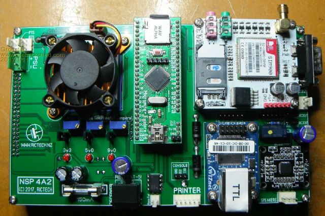

  Grogster said
There is a fan that goes on the top of the heatsink, but this is not shown.
The two 3mm bolts secure the three regulator IC's to the bottom of the heatsink, using a bit of 3mm aluminium plate as a load-spreader/clamp thing.....
  Grogster said   It is a replacement security system. This is the new replacement for the old system that was cooked in the October lightning strike from God, which used the old - now obsolete - uALFAT filesystem module that I had a bit of a mission finding temporary replacements for. That system was PICAXE based(28X2) with the filesystem module and a TellyMate chip for B/W video output on a standard TV screen.
This one uses the MM+ and a colour touch-screen. Much sexier then the PICAXE system.
The old system used a very noisy, big and heavy dot-matrix printer for printing messages. The new one uses a relatively silent thermal printer which is panel-mounted with the LCD to keep things nice and tidy.

Here is another photo complete with fan this time.
A YouTube video is a nice idea - I will see what I can do.

99% of the security system using the board above is also wireless, but when you get a strike of that size, it just blasts through everything. We have fitted earthing rods and bars to the comms rooms now, but I doubt they would really offer that much protection when you are talking a "1.21 Gigawatt" discharge.
While the actual transmitter nodes survive OK cos they are battery powered, the nexus of hardware forming the system is still tethered by cables to the power network and as such, is always going to be at risk to some extent if something like this happens.
