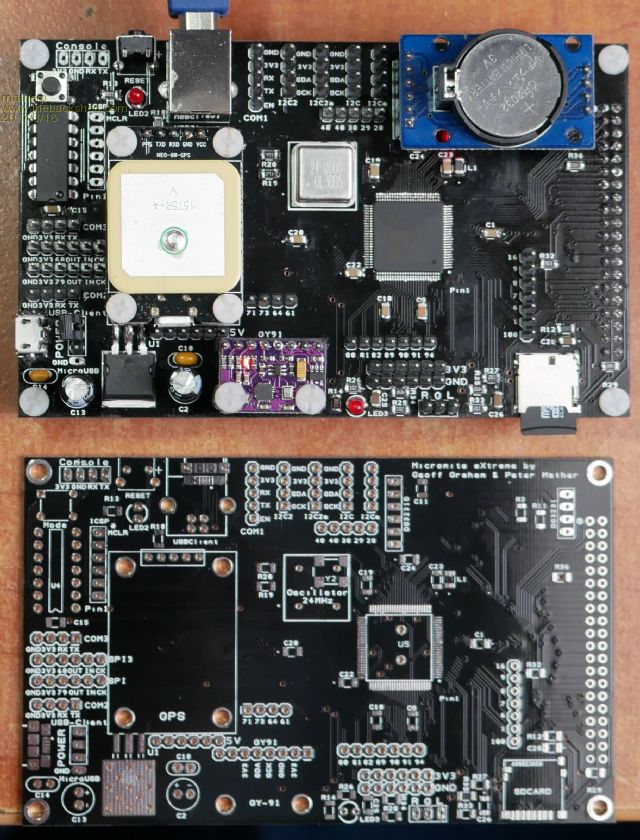

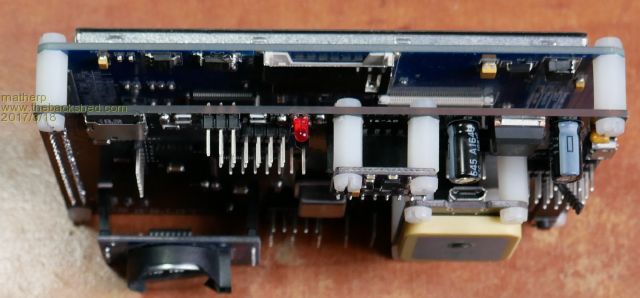

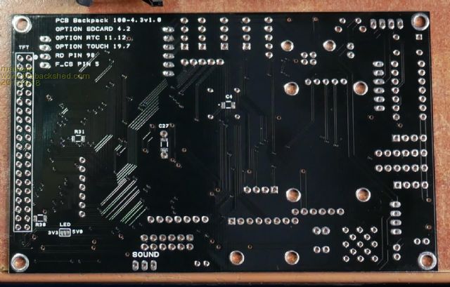

Here is a new PCB for the 100-pin Micromite eXtreme.
This is sized to mount the 4.3" SSD1963 display and has mounting for a GPS
A 10-DOF AHRS
And if required a RTC module
All the pins are broken out somewhere on the board and as usual it uses a PIC16F1454 as a USB/UART and onboard PIC32 programmer
Here is the full schematic
2017-03-18_163345_Schematic.pdf
If anyone wants the gerbers let me know. If you want a built version you need to twist one of the usual suspects' arms.

@ Matherp
On the Schematic there are 2 pull up resistors on the I2C Bus. R21 and R22 but I can't find them on the PCB. Are they not needed. There are 2 resistors in the sound output not marked but I can probably work them out. Also can't find R33 on the schematic.
Paul.Edited by palcal 2017-05-15
Posts: 11949
Posted: 09:27pm 13 May 2017
Hi Paul
R21 and R22 are the pullups on the I2C2 bus - they were missed off this version of the board - sorry
R33 is the left resistor in the audio right channel, same as r28 for the left channel, R35 is the centre resistor in the audio right channel, same as R34 for the left.
