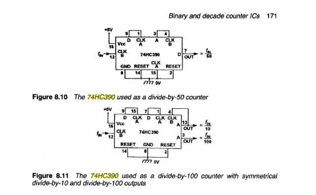

Hello all
I am desperately trying to find a table of pins to be strapped/earthed/etc. for the various divide possibilities of the 74HC390 (2,4,5,10,20,25,50,100). I cannot glean those from the datasheets (not being a genius). For example, I know from a Mr Carlson's Lab YouTube clip that for divide by 4 you strap 14 and 12, strap 15 and 3, input at 1, output at 13, strap 4,2,8,14,12 to earth. Where would I find the strappings for the other divisors?

Hi Herry,
From this Link which is a preview of an ebook available online.
Page 171 has these examples. for /50 /10 and /100
There is a bit of reading about the others but as it is your baby I am hand balling it back to you to read up on them..

Thanks MIck
I was aware of that reference and it gives me two strappings. But my theoretical knowledge is not enough to extrapolate other strappings from the datasheet!

74HC390:
Divide by 2:
in: 1
out: 3
gnd: 2,4,8,12,14,15
Divide by 4:
in: 1
out: 13
12-14
3-15
gnd: 2,4,8,12,14
Divide by 5:
in: 4
out: 7
gnd: 1,2,8,12,14,15
Divide by 10:
in: 1
out: 7
3-4
gnd: 2,8,12,14,15
Divide by 20:
in: 1
out: 13
3-4
7-15
gnd: 2,8,12,14
Divide by 25:
in: 4
out: 9
7-12
gnd: 1,2,8,14,15
Divide by 50:
in: 12
out: 7
1-9
3-4
gnd: 2,8,14,15
Divide by 100:
in:12
out: 3
9-15
1-7
4-13
gnd: 2,4,8
