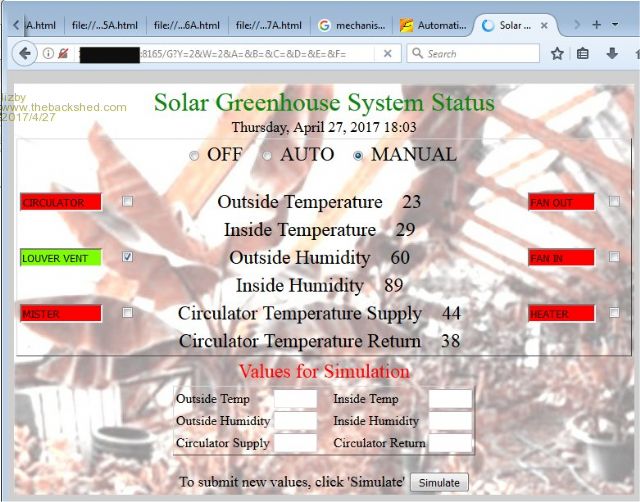

This is really an HTML question, not a Micromite question, but I think it's related to my HTML being served by a Micromite Explore-28 instead of a normal server, so I'll ask here.
Here is the page I'm serving:
It displays well, but the connection doesn't close, which causes problems with Chrome on a PC (I have to press "Reload") but not on Firefox and other browsers I've tested. The problem also occurs on Opera and Chrome on Android.
I start the transmission after the Micromite decodes a request with:
HTTP/1.1 200 OK
Content-type: text/html
Connection: close
Then the body:
<html> <title>Solar Greenhouse System</title> <head></head> <BODY bgcolor='#d0d0d0'>
[etc.]
and close with " </form> </BODY> </html>"
I have "Y"ed off the serial output from the Micromite to a serial port for monitoring, so I can see that this is exactly what is being sent.
The requests I'm getting from the different browsers include "Connection: keep-alive", which I suspect is causing my problem. With the Firefox browser, the page loads but the little wheel on the browser tab goes round and round (as can be seen in the image)--but with Chrome, I get "Page can't load", but [Reload] works (and the wheel goes around).
Is there something else I can do to make sure the connection closes (assuming that that is my problem)?
I've attached the entire HTML output. The part beginning <html> can be saved to a file and it loads perfectly well into a browser.
2017-04-27_212427_gh_html_output.zip
(I have addressed the "favicon" issue with an embedded data icon, if anyone thinks that might be the problem--I see now no favicon requests.)Edited by lizby 2017-04-28

The problem is not with the HTML.
It has more to do with the HTTP protocol and the underlying TCP protocol.
HTTP uses a header "content-length" to tell the receiving end how many bytes of data to expect. After this the connection can be closed.
For dynamically created content you will not know at the time the headers are send how long the data stream will be.
You just stream the data and at the end you close the connection on the server side.
Best to wait a little while as it can be possible that the closing command will terminate the last data block. This is a brute force method not the recommended way.
A better solutions (if possible) is to do a 'half close' on the tcp connection. You close the output and then wait until the receiver also closes it output. Then you close it fully. This can only work when you have access to the tcp connection. Even then you should have a timeout so that if the receiver does not close its side, you still brute force close your side fully.
For all the detail about http see: http://www.w3.org/Protocols/rfc2616/rfc2616.txt

Microblocks--since this is served on a Micromite Explore-28 through a little openWrt router running ser2net (which converts serial input to TCP), I'm not sure how I either close or half-close the TCP connection. Do you see a way?
It may be possible for me to build the entire string on the micromite using the long string function, then I would know the content-length and could use that before squirting out the html.
I'll add the "<!DOCTYPE html>".[DONE]

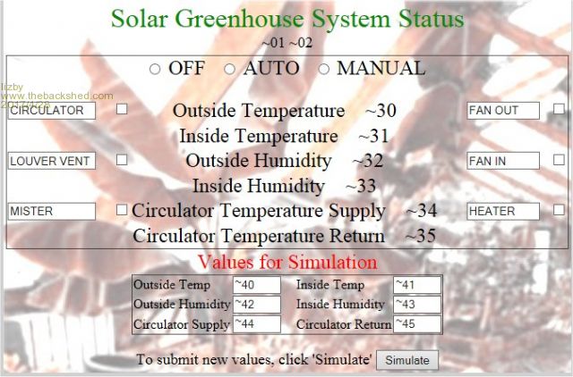

Posts: 3881
Posted: 03:15am 28 Apr 2017
Doug--could you explain what you mean by mismatched elements? (By the way, I thought overnight that I might not have <table></table>, <tr></tr>, <td></td> properly balanced, so I'm writing a program to outline that structure).
The HTML code is built following a practice I've been using since 2006 with the picaxe and SimpleLan ethernet module (long since discontinued).
I hand-code an html template and designate variables that I want to be able to change with a "~" followed by 2 digits. For example, I customarily use "~01" for date and "~02" for time. I store the template on the microprocessor--either in eeprom for a picaxe, on the SD for a Micromite Explore-64, or after being coded programmatically as basic assignment statements for the Explore-28--and then run through it in code replacing the "~nn" text with current variable values.
In order to align things the way I want, I use a table as master container, then other tables within it to create a column structure.
The template will display in a browser, though not all the "~nn"s will (because of their use as "checked" fields for checkboxes and radio boxes, or as background color--happily browsers generally ignore what they don't understand).
Here is the displayed template for this application--you can see "~30"-"~35" which will be replaced with sensor readings, and also "~40"-"~45", which can be used to simulate those sensor readings for testing the code when the "AUTO" operating mode is selected.
I am serving this remotely (through the openWrt box and ser2net and my gateway router) so that someone who is 100 miles away can test it.

Posts: 3881
Posted: 08:04am 28 Apr 2017
Thanks for the suggestions. If I haven't confused myself trying the permutations, "HTTP/1.0 200 OK" with no "Connection Close" made no difference--I still got back "HTTP/1.1" and "Connection: keep-alive", and still the browser didn't indicate that the connection was closed. And I got favicon requests again, perhaps because with HTTP 1.0 requested, the data tag was ignored.
"<!DOCTYPE html>" didn't work with HTTP 1.0 requested (no surprise there). With HTTP 1.1 I could see no difference.
I double-checked, with the assistance of a program, and it appears to me that the <table></table>, <tr></tr>, and <td></td> tags are balanced (remembering that I have tables within <td></td> tags).
I think the next thing to try is to get an accurate Connection-Length.
It works pretty well on Firefox and IE--I'd just like it to work without reloading on Chrome on the PC and especially Chrome and Opera on Android.
Microblocks--with this setup, going through ser2net, how would I close the connection?
Edited by lizby 2017-04-29

Posts: 3881
Posted: 05:15am 29 Apr 2017
"[ser2net] is open source thought so you might be able to adapt the code to inspect the data coming from the serial port for a special character or escape sequence to close the tcp connection."
That sounds hard. Easier to count the characters. I tried to make it so that there were few if any variations in the length of the served text. This involved changing the full month and day names to 3-character shortenings, replacing the color names "chartreuse" and "red" with their hex codes, "#7fff00" and "#ff0000", and putting "......." in checkboxes and radio boxes not "checked" (which browsers ignored).
Then I ran through my output routine, counting but not outputting the characters. That gave me a "Content-Length" to plug in when I actually output the HTML upon receiving a browser request. I padded the end with some extra spaces.
As a result, the connection successfully closes now on Chrome and IE and Firefox on the PC, and the glitches with Chrome which required "Reload" have ceased. It also works on Android with Chrome. On Android with Opera, the first request works, but subsequent updates result in the HTML code being printed as text, even when I include "<!DOCTYPE html>" at the beginning (that displays too, and the same without it).
So even with a remaining glitch with one browser on Android, I am happy with the solution. Thanks very much for all the suggestions.
