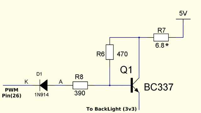

I am having issues with a simple backlight circuit with the ILI9341. I had assumed that the internal circuitry of the LCD module was just a pin to resistor to the backlight LED to negative but there seems to be something else happening. I have used a BC338 transistor with base to pin 24 via a 1K resistor, the collector to 5V supply via a 82 ohm resistor and the emitter connected to the LED pin (8). This circuit works until the display is addressed then stops. I can operate the backlight using only pin 8 and 2 by pin(24)=1 and off with pin(24)=0. When I operate with the LCD fully connected I cant operate the backlight yet if I short emitter to collector of the BC338 the backlight works.

There was an extensive discussion on this 12-18 months ago.
It really is not easy to drive a 3v3 powered LED circuit fully using a 3v3 high level drive)
The circuit below is what I use for my BackPack 170 and does work very well.. The resistor values are pretty tight so you may not get a good result by changing them but it has always worked well using the values shown. I tried a BC558 transistor but could not get full brightness).
You can use PWM to set any value brightness between OFF and ON or simply any 3v3 output pin so that LOW=OFF and HI=ON.

Graeme,
The secret to the above circuit is the blocking diode, this allows the transistor bias resistors to pull the base of the BC337 to around 3v8 or slightly higher to turn the transistor on without causing damage to the 3v3 level PIC pin.. The backlight will draw about 60-70mA at around 3v3 when on.
In any case it just works.. All my backlight boards now use this circuit..
