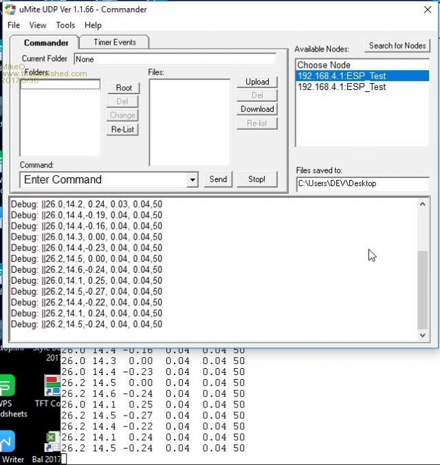

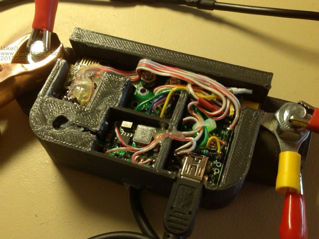

Just a quick post, my latest project using the fantastic little gem from Grogster and Rob. Its a 12v Battery monitor (inspired by BMPRO Device no doupt ) , +-30amps. It outputs on wifi and Usb serial Actual Voltage and current , accumulated Load and Charge AmpHrs , Battery temperature and State of Charge.
Photo shows 3D printed enclosure , Battery terminals, from left ESP8266 wifi, ASC711EX current sense, Explore 28,bottom left Temp sensor and DC to DC PSU.
This photo shows the Output @ 5sec intervals.
Temp, Volts, Current, Load AmpHrs, Charge AmpHrs, %State of Charge
The photo shows a Windows app displaying data stream via wifi (UDP) and below is the USB serial. The Windows app I wrote some time ago to communicate with ESP8266 UDP protocol, I will probably write a more specific app to communicate with the Battery Monitor for windows, I am also trying to learn(get to grips with) B4A so I can make one for Android phone which would possibly be more convenient. Alternately another uMite backpack with LCD display could be used displaying the serial data.
I will post more soon.

Really nice job Mike - amazing how neatly a 3D printer can tidy up a heap of modules! What are the dimensions of the 'box'?
Greg
MikeO
Joined: 11/09/2011
Posts: 275
Posted: 12:07am 31 May 2017
Thank's Greg
Dimensions are 120 x 50 x 30mm
Mike

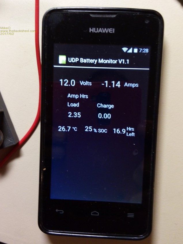

Update, I have written a very simple android app now running on my phone to receive the data stream from the Battery Monitor. This has other possibilities as well i think.
