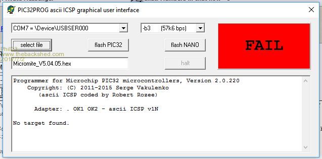

Just attempted to upgrade a few of my devices to 5.04.05 with the Microbridge Y not having any luck.
Sometimes I don't get the LED to light when I press the program button, seems a bit timing based maybe.
But when I do get it to come on the program reports target not found.
First devices I was trying were 28 pin backpacks & when I changes back to the Nano based programmer they both flashed ok.
Any ideas anyone?

Phil23
Joined: 27/03/2016
Posts: 1667
Posted: 02:38am 02 Jul 2017
  Geoffg said  You might have a power supply issue.
Power seems to be the issue.
Same failure with an E64 with just the M/B.
But if I power the E64 via a different USB port it flashes fine.
And way faster than the Nano. 2:06 Vs 52 seconds.
Suspect it might be something to do with Toshiba's power management.
Phil

Phil23
Joined: 27/03/2016
Posts: 1667
Posted: 09:23pm 02 Jul 2017
So after a close look at the diagrams in Silicon Chip, (and reading things...),
I see there is no power to Pin 3 of the ICSP connector; that's what was causing me to get no Target Found.
Must say I overlooked that & presumed power was present, & it behaved like the Arduino Nano programmer & powered the Pic from via the ICSP connector.
Also the photo of it alone plugged in to the backpack above the PicKit3, added to that assumption.
So is it fair enough to hardwire the 3.3V to Pin 2 on the ICSP?
Or is that going to give me other limitations on different devices.
Phil.
Posts: 2998
Posted: 01:16am 03 Jul 2017
Hi Phil,
That will work BUT beware of a couple of things:
1> If flashing the BackPack (as you originally mentioned) then I would remove the TFT to minimise current draw. The vReg on the MB module is good for 250mA max. With a TFT attached, the BackLight may exceed the amount of power available on the 3v3 output; but all will definitely be ok without the TFT attached.
2> When using the MB to flash other MM modules, you will need to ensure that 3v3 (or other voltage close to this figure) is not present on the ICSP pin 2.
Maybe worth making a mini strip-board 'adaptor' with a single jumper link onboard. Have the 5 signal strips running from 'in' to 'out' (female/male headers at each end to suit your setup) with a single jumper link in series with the pin2 in/out strip (cut this strip obviously to 'insert' the jumper).
Hope this makes sense.
