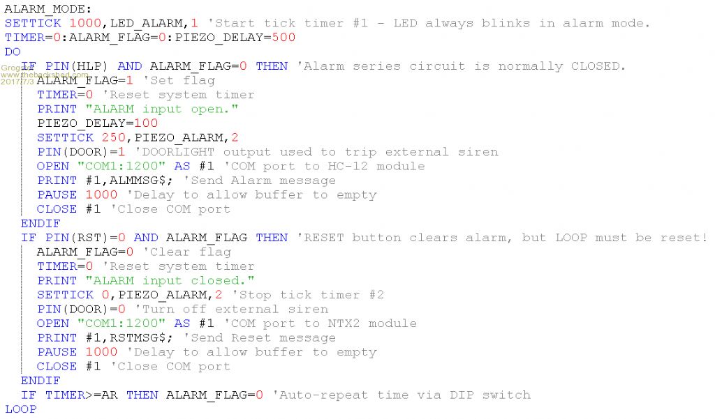

Hi there.
MM2 version 5.04.04
1) Com port closed - no rogue data.
2) OPEN com port, send some data. This is received OK.
3) CLOSE com port, rogue data starts being sent.
This is a MM connected to an HC-12, and at power-up, the HC-12 does not send any rogue data, and it is just fine till the first cycle, then as soon as you close the com port, the HC-12 starts sending rogue data across the link - which totally screws up the other end.
I am thinking I might be able to fix this by leaving the com port open(IE: don't close it), but one of the reasons for closing it, was to keep the buffer purged so I don't get this crud in the first place in the data-stream.
The HC-12 has on-board pull-ups, so I should not need any on my board as the HC-12 provides them for me.
COM1 on MM2, which is 5v tolerant. No resistors between HC-12 and MM2(directly connected)
Baud-rate is 1200, so very slow.
I will be putting the logic analyser on it tomorrow, but from experiments at the console, the data appears to just be garbage. Most of the bytes received into the buffer are non-printable characters, so it's almost like the white-noise garbage you get on a "Dumb" receiver before you sync it with the likes of 0101010101 kind of thing.
With my having completed one cycle, and running a simple code at the other end to print the com port buffer size to the console, I get the following output:
The zeros at the top are at power-up OF THE TRANSMITTING MM - so no problems till you send the first transmission - 10 bytes. After that, the buffer just keeps filling up with garbage. There are plenty more plain zeros above this screen shot, but I cropped them out as they are always zero till the first transmission cycle.
Can anyone else suggest anything I should try at this point?
EDIT: Here is the test alarm code that is doing this very odd com-port behaviour.
It is indeed possible, that the HC-12 I am using is crook or something, so I will be checking what is indeed coming out of the MM COM port on the logic analyser tomorrow - perhaps the HC-12 is unstable and is generating the problem internally? Anyone seen that before?Edited by Grogster 2017-07-04

Posts: 10082
Posted: 04:58pm 03 Jul 2017
Thanks for the replies.
Logic Analyser says that all that crud at the end are "Framing errors", most equal to zero.
This is with the logic analyser directly on the COM1 TX line and ground. The wanted data is there, but it is followed up with random garbage.
I will now isolate COM1:TXD and tap directly into THAT and see if I still get the rubbish, as that would mean it IS coming from the MM2 chip, and not the HC-12.
Will keep you all updated.
Posts: 10082
Posted: 05:05pm 03 Jul 2017
UPDATE:
MM2 is in the clear - no problems there when I send the data. It is PERFECT out of the MM2, and EXACTLY as it should be. Connect the HC-12 to the line, and you get the garbage.
With the MM2 feeding the logic analyser, but the HC-12 disconnected from COM1:TXD, there is no problem with either the serial output of the MM2, or the HC-12 - it does not send any rogue data. If I reconnect the COM1:TXD line to the HC-12, the problem resurfaces.
Bizzare....
I will now setup the code in the MM2 transmitter so that after a close, it makes the pin an output and sets it high. I might also try hacking a 4k7 pull-up to this line, although, I did not think it would be needed, as the HC-12 has it's own pullups.....
Posts: 10082
Posted: 05:39pm 03 Jul 2017
UPDATE:
OK, if I SETPIN 21,OFF before I open the com port, then after I close it, I SETPIN 21,DOUT:PIN(21)=1 to make it idle-high, this seems to be stopping all the rogue data in initial tests - so far.
The HC-12 still seems to be appending 0xFF(255) to the end of EVERY message, even though I have not asked for that, but so long as it keeps doing that, I can use THAT as my end of message byte rather then CR.
I am now going to connect to the logic analyser again and check what is coming out.
The experimentation continues.
Posts: 10082
Posted: 07:28pm 03 Jul 2017
UPDATE:
OK, I think we are making progress here.
I have added a 4k7 pull-up to 3v3 on the COM1:TXD line, and all the problems have vanished - for now.
I think that the reason it worked fine on the FIRST cycle through, was that at power-up, all I/O pins are set as INPUTS, but critically at this point, they are NOT left floating.
So, the first transmission cycle works, but then the code runs into the CLOSE command, and leaves the pin in a floating state, and the HC-12 is trying to react to this as data when it isn't.
The pull-up seems to have fixed this, and I have removed the SETPIN commands from the post above, and everything is working well now.
I'll keep my fingers crossed, but I expect that was why the first cycle worked - and was confusing the hell out of me as to WHY it worked OK once, but not more then that.
Posts: 10082
Posted: 07:57pm 03 Jul 2017
UPDATE:
Perhaps not....
Put it all back together with the 4k7 pull-up, and getting garbage again.
I think I might need to keep the before/after PIN config after all(SETPIN).
I guess the pin IS still technically floating following the CLOSE command, so even with the 4k7 pull-up, if it floats down this is enough to trip the HC-12 and it thinks it needs to respond.
The saga continues....

Posts: 10082
Posted: 09:10pm 03 Jul 2017
Hi Jim.
5v for the HC-12.
I think I will change the code to leave the com port open rather then close it.
I could also perhaps make use of the ChangePin Cfunction, and set a permanent pull-up on it. That would save me having to get more PCB's done for the sake of one resistor.
EDIT: I can't do that. The ChangePin Cfunction specifically says not to enable pullups on an output, which is what COM1:TXD is. I will leave the 4k7 external resistor in place for good luck, and just not close the port.
Yes, I too thought the internal pull-up would do it, but it must be a rather high-value pull-up. It could be 500k or 1M or something for all I know. I have not been able to find a schematic for the HC-12 as yet.Edited by Grogster 2017-07-05

Posts: 10082
Posted: 09:19pm 03 Jul 2017
Nice idea, Captain.
I will do that now as part of the latest round of mods.
The problem does indeed seem to stem from the fact that the MM2 pin is left floating when you close the port, so your diode is a nice idea.(not forgetting the 4k7 resistor too)
I've used the HC-12 on the PICAXE chips before and never had this issue, so it was kinda unexpected!
EDIT: Nope, diode and pullup make it go even MORE nuts:
It's fine till the first transmit cycle - same as before, but this time the garbage data goes off the charts very quickly. This is with a diode on TXD, anode to HC-12, cathode to MM2, with 4k7 pull-up to HC-12 and anode of diode.
I will remove this, and change the programming to NOT close the com port and see what happens.

You have a SETPIN command for that.
Maybe the CLOSE command can be adjusted to not put those pins in an unconfigured state as they would still be connected to a serial device anyway.
Posts: 10082
Posted: 11:35pm 03 Jul 2017
UPDATE:
OK, Things have settled down now, but ONLY if I leave the COM port open all the time, so open it at the start of the code before the main loop, and never close it. I left the 4k7 pull-up to 5v in place, and with this situation, it is working OK - no rogue bytes.
More testing required, but it IS doing what is expected of it now, both the MM2 and the HC-12, but this was a little bit of a curly one....

Yes, I am reasonably confident that the cause was my closing the COM port, but as MikroBlocks says above - once you decide to use the COM port pins, you don't generally use them for anything else, so I guess I am safe enough leaving it open all the time.
My primary reason for closing it, was just to flush the buffer so that every time it went to send some data, you could be sure it was starting at the start, so to speak, and not adding the wanted data, on to the back of something else still in the buffer.
This does not seem to be happening, so I guess perhaps I was worried about nothing there. Time for sleep.

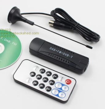

Hadn't thought of using my scanner; I've got a similar older Uniden here.
What I do find very useful though is a Software Defined Radio.
Cheap USB TV receiver dongle ;
Then this Software.
Gives me a cheap & dirty spectrum analyser.
A real one would be nicer, but a bit more than $15.00.
