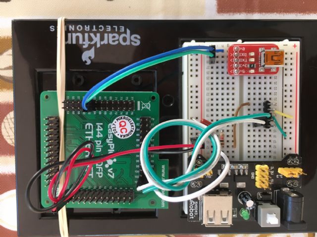

After realizing that the pin numbers on this PIC32MZ board do NOT correspond to the chip pin numbers, I was able to program this card with MMX MMBASIC. I followed the schematic for the 144 pin MMX board purchased from Phil at micromite.org.
Here's a picture of the setup for programming and communicating with the board. It includes one of Phil's USB interface boards (upper right corner) and an ICSP connector (middle right) configured as MCLR => pin 91, PGD => pin 101, PGC => 102.
The 3.3 volt power supply is located at the lower right with connections to pin 26 (3.3 volt) and pin 25 as ground. The USB-RX is connected to pin 64 and the TX to pin 63 of the PIC32MZ board.
